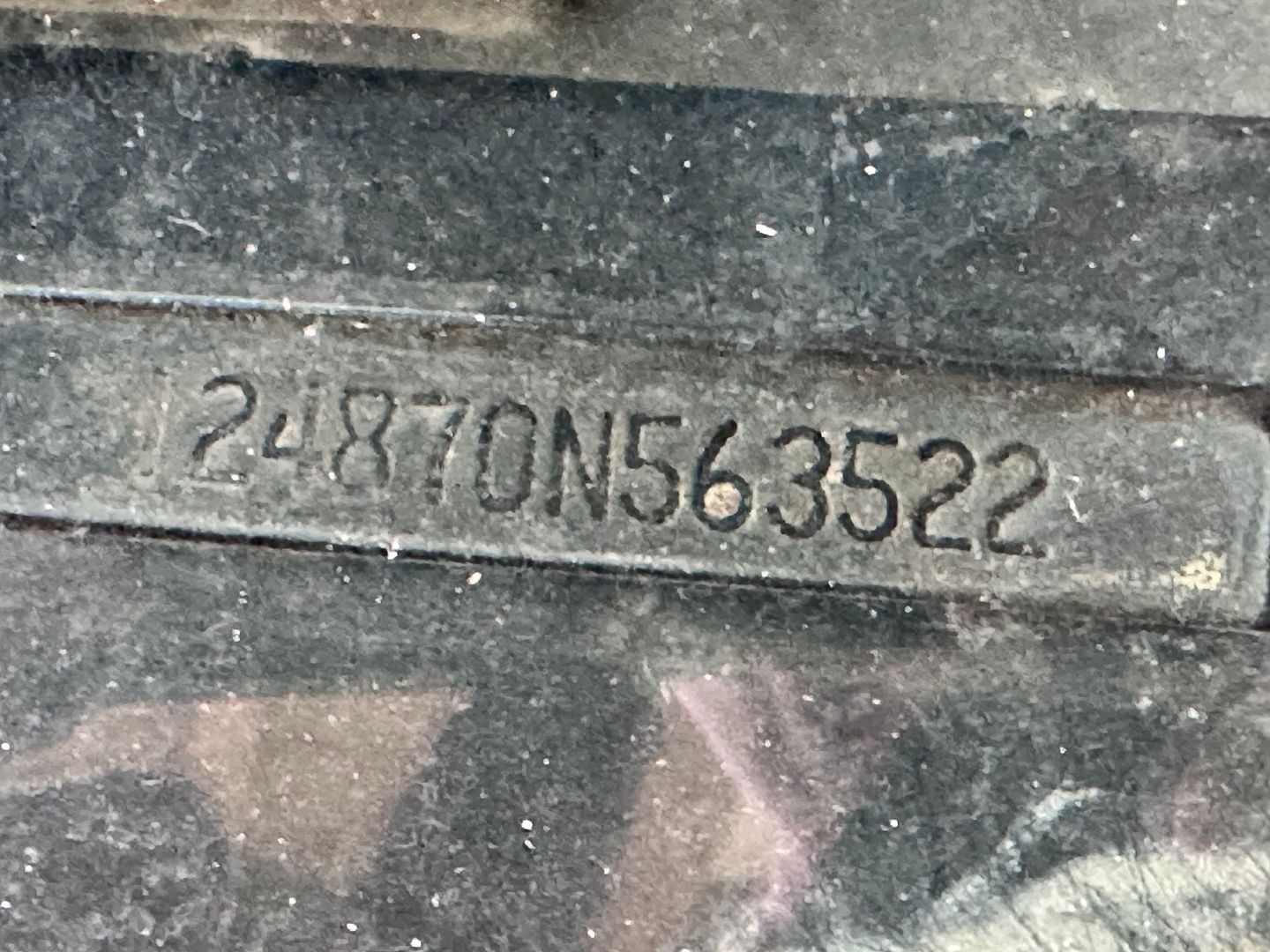

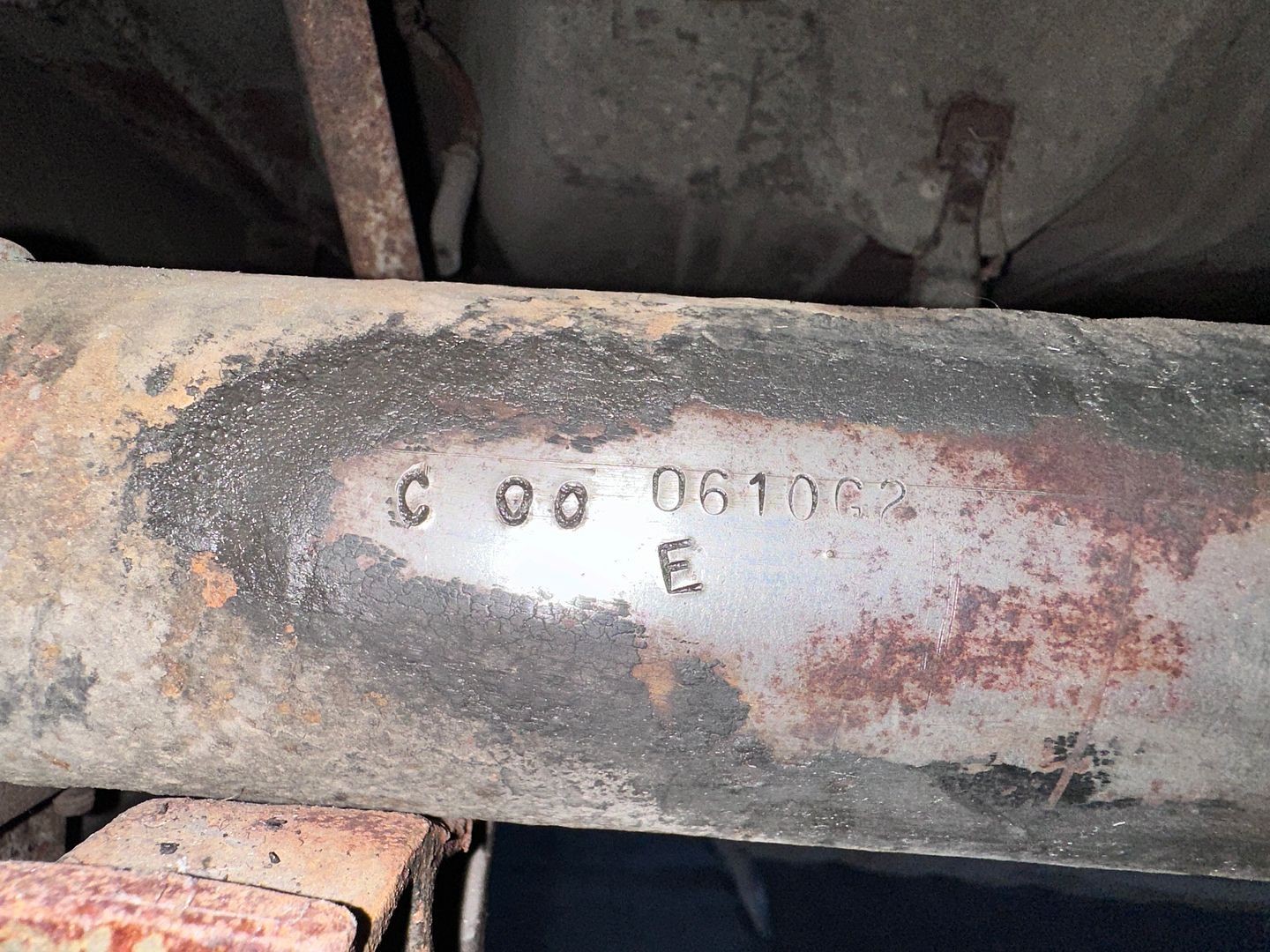

Anyway, I know of a '70 Camaro SS L78 with what appears to be the original engine.
I'll post some images of the various stamps, codes, and casting numbers and would be great to get some feedback on whether it's the original engine or not.

Looks like a good car! The double VIN stamp is pretty common. Both of my cars have a double stamp, with one being a Norwood and the other a Van Nuys car.
The COO characters in the axle look a little odd but the build date is right on... Most of them are approx. 2 weeks before the cowl tag date.
