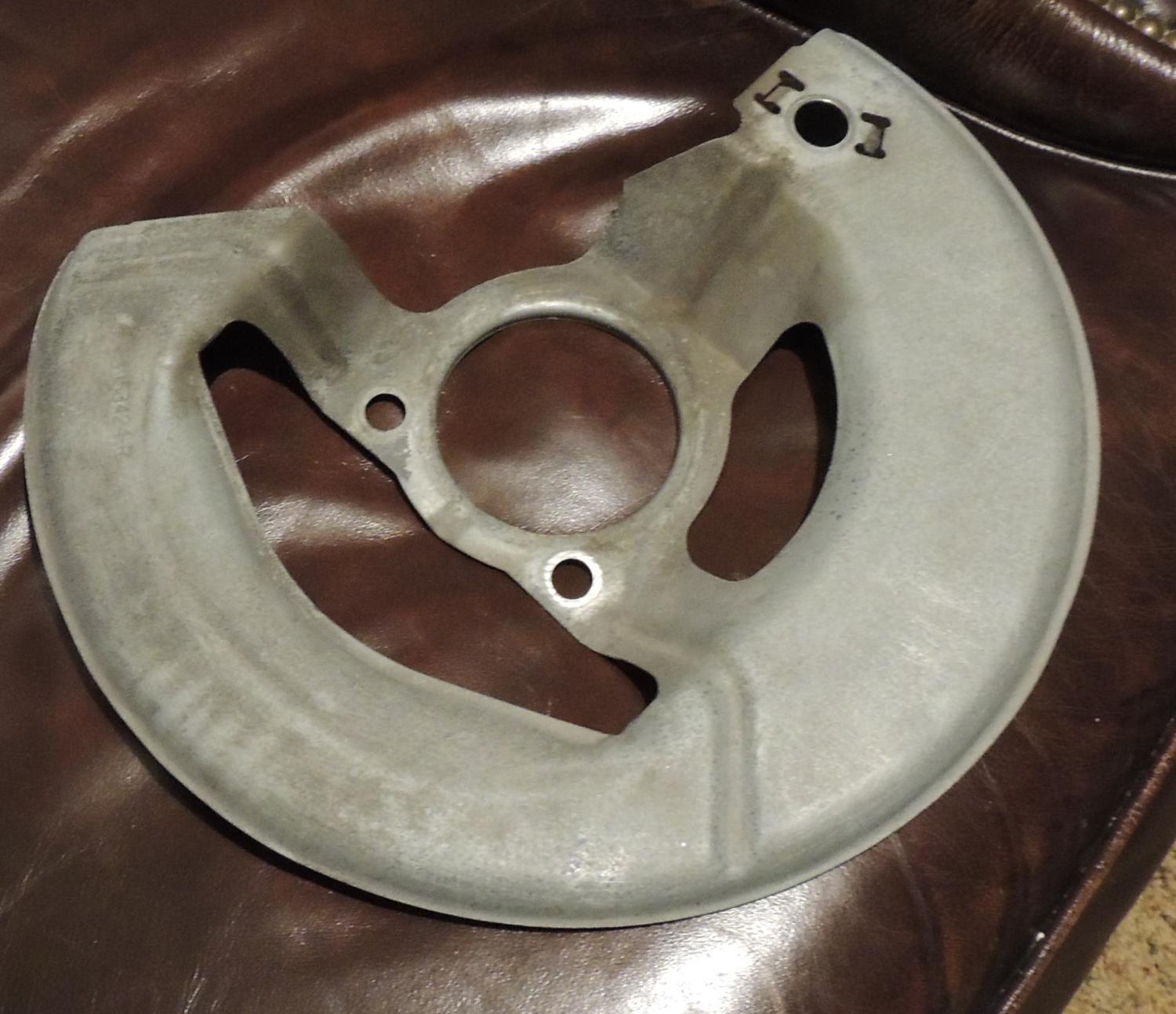

This is from my 8900 mile car......

Thanks. I have three that look almost that good. Any idea how it is plated?
Silver cad? Galvanized? Painted?
This car is not getting judged, and will have a couple of day two parts. But, I still want it somewhat correct for when I go to sell it.

I was of the opinion cad plated

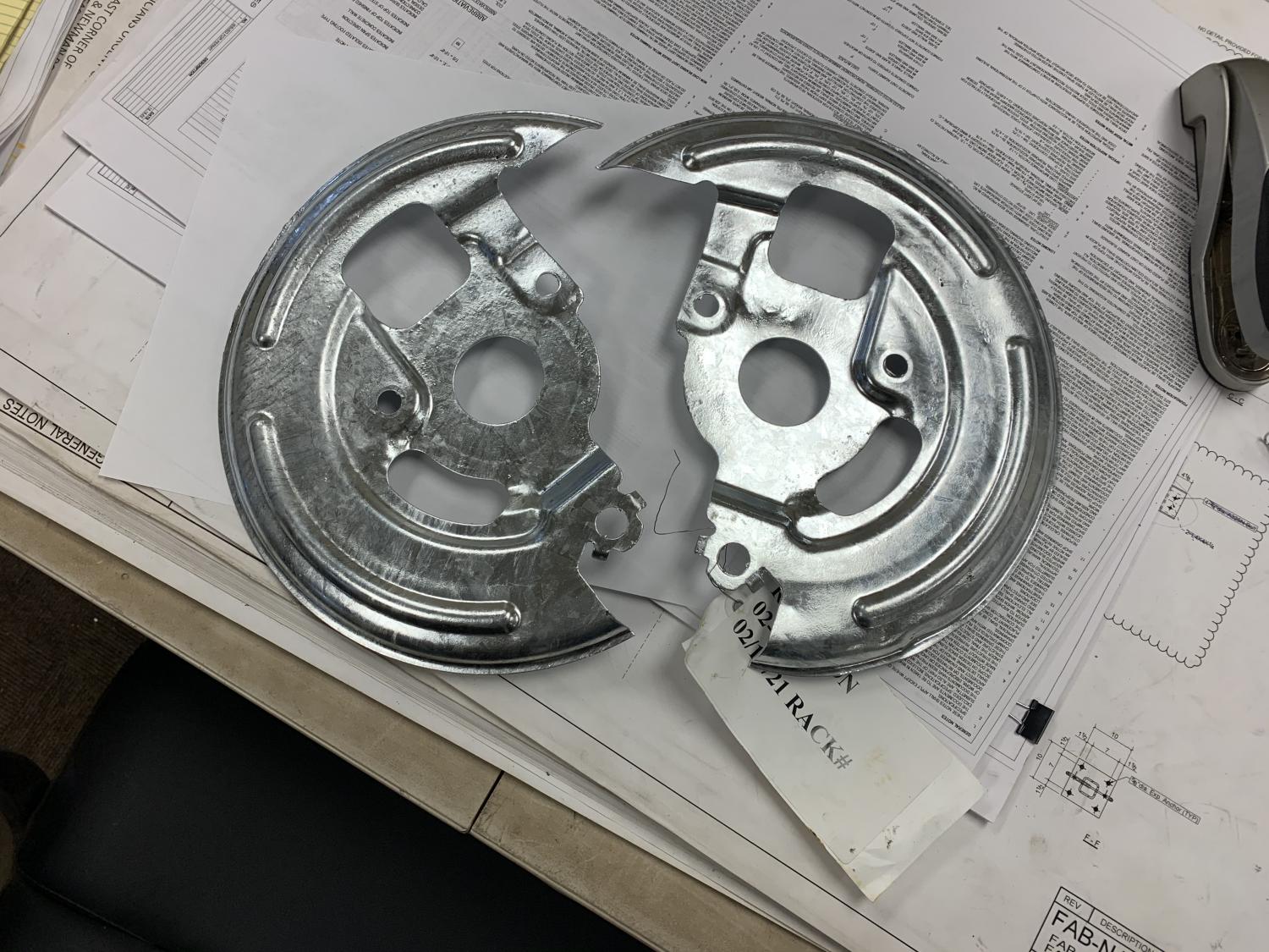

Galvanizers are becoming tougher to find for sure but I was able to get my originals re-done through an ornamental iron supplier I work with.
Jake Dykstra

VERY nice !!
Looks like you could set up a nice sideline with that plater...

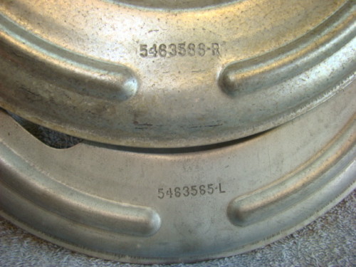

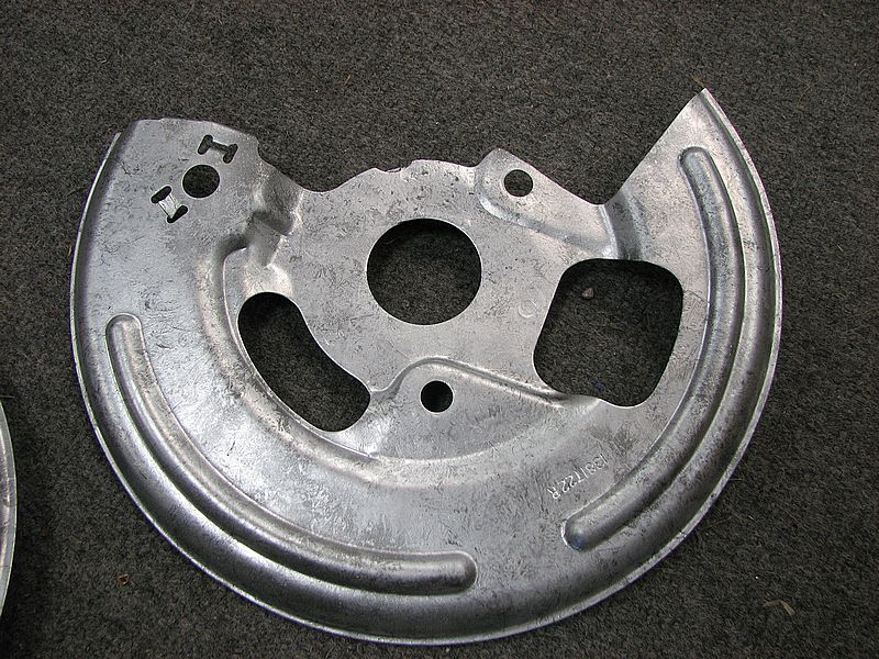

Jake, those look fairly accurate. I have yet to find someone who could galvanize them correctly and yours are damn close albeit a little shinny. I did these using the mottling process 70post mentioned earlier. I think I got them fairly close.
The first photo is of a pair of NOS. The second photo is mine on top of the NOS and the last photo is mine overall.
I have also had mine zinc plated and then hit them ever so lightly in the glass media cabinet to dull them a bit. Those looked pretty good as well.
