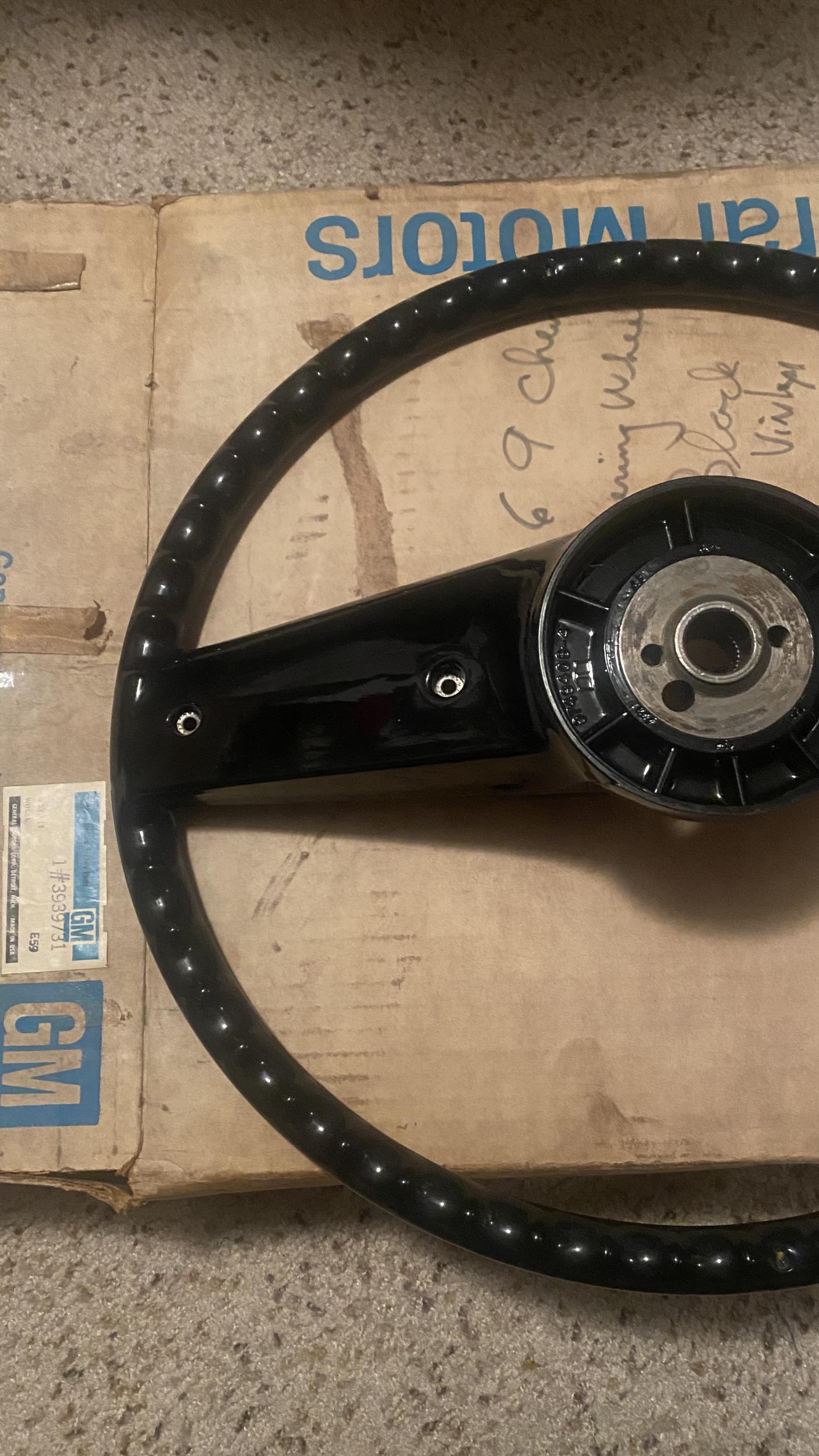

Has anyone been able to paint 1969 steering wheels. I thought they were plastic, but when I got off the phone with SEM Products tech line, they said the 1969 steering wheels were made of nylon. They he told me that paint will not stick to nylon. Does anyone have any input on this subject?
