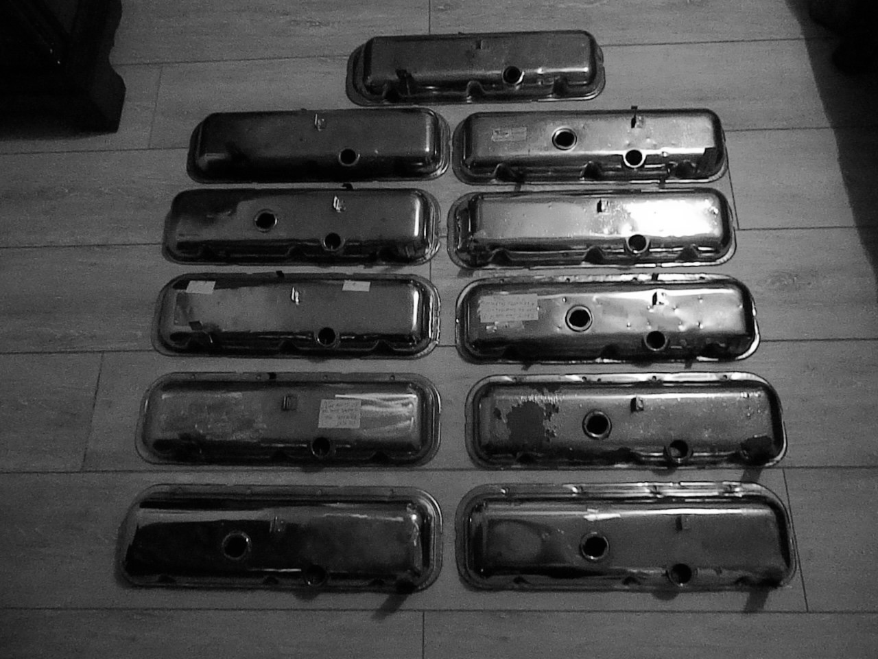

After seeing the photo's of the air cleaner you sent me, I have corresponded with Dan at The Chrome Shop and I will be sending 11 BB valve covers out on Monday. For those of you who might be interested in buying original GM valve covers, I am only sending out 1969 Camaro & 1970 Chevelle valve covers that will be available in the future.

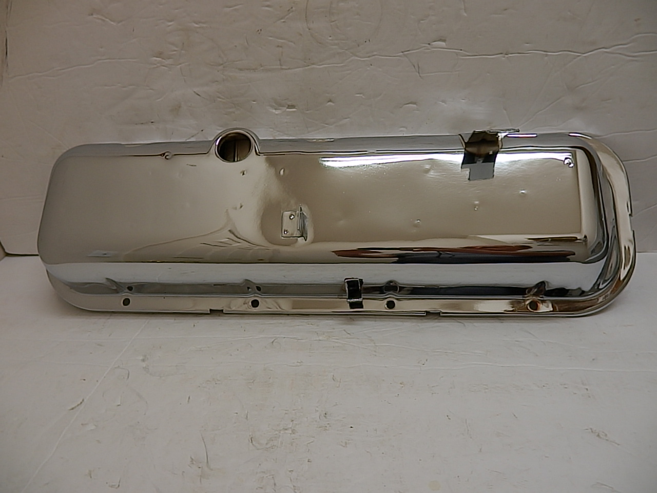

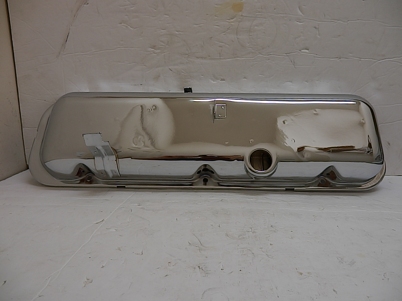

I sent my 11 valve covers to The Chrome Shop 0n Dec. 3rd, 2023, to may surprise, on Thursday Dec 21, 2023 I received a package in the mail from The Chrome Shop, Dan wanted my opinion before he proceeded with the other 9. This is a left side 1970 Chevelle, and yes the dimples are still there.
