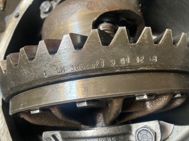

is there anyway to identify that a posi is copo other than take it apart and count the gears. Here are some photos of one I have in a rearend. Appears to be 8 teeth showing on the spider gear but its hard to tell. The window openings look like the previous post. What are your thoughts. Thanks, Larry

A round hole in the stamped steel spring plates is another indicator.

Most 4 series cases have the small square hole. I've seen a few with the larger oval hole. but not many. All Eaton gear sets have 10 teeth on the pinion gears. They are 18-10, 17-10 and 16-10. Standard units from Chevy are 18-10. Eaton made a heavy duty unit that was also sold by Moroso that had 17-10 gears and the COPO units had 16-10 gears. New Eaton units have 17-10 gears that are made from powdered metal.
Your preload plates look like they have oval holes in them, which would not be in a COPO unit.
