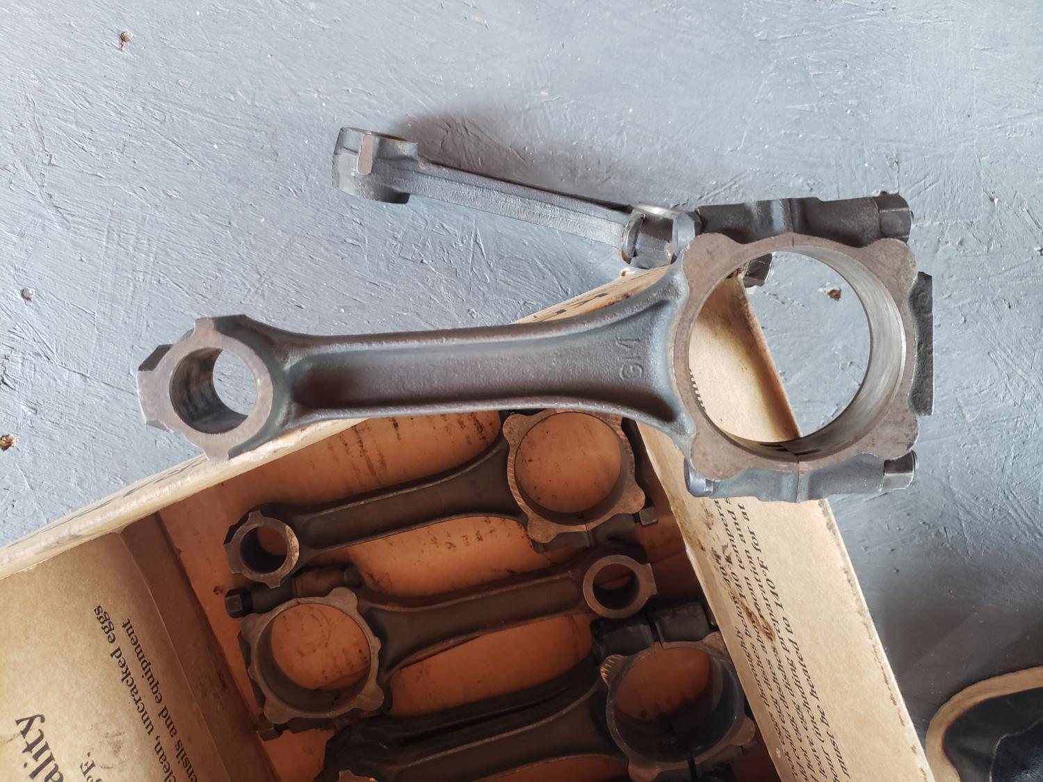

I just picked up a '63 Pontiac 421(28g suffix) #544988 block. It came with a box of 8 forged con rods. I'm trying to find accurate information to identify these rods and finding very little..other than the forgings are very rare. So, here is a pic.. any help?

The good early forged rods are the 421SDs.The bolt length is the diff from the pass car rods.Will look it up tomorrow and get back to you.Tom

Those are 63-65 HO rods.I would use aftermarket instead.Tom

FYI,the forged 58-62 rods were called the rubber rods,low heat treating.The next were better but not as good as the 421SDs.Myself I would use aftermarket forged over any of the factory early forged rods.The 421 HO I’m driving I actually used the 69-70 cast rods over the early forged.Tom
