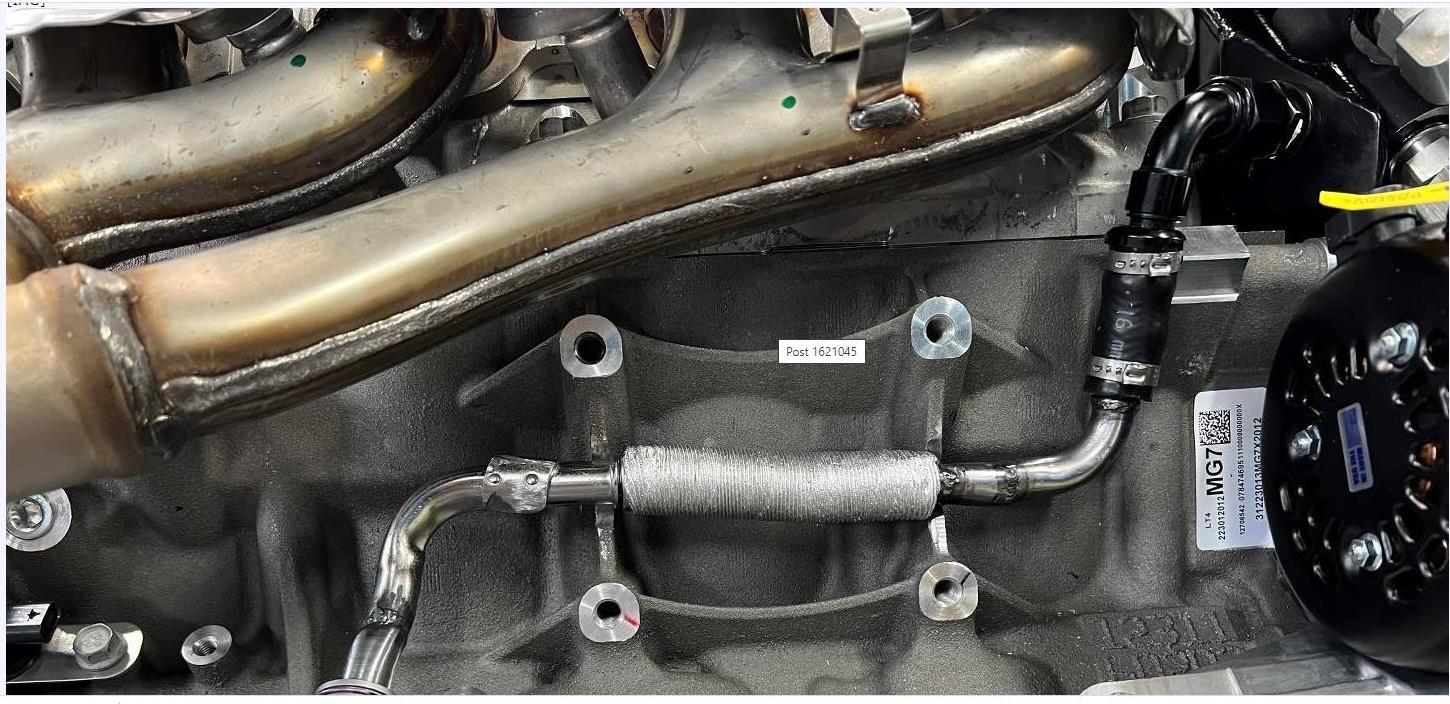

I'm getting an education with the differences between the LS and the LT engines........ to be explained in future posts.......The first issue I encountered was changing to the Holley 302-20 oil pan........Mounted the engine on a engine stand and flipped the engine over to change the pan...... Simple..Right!!!.....when I opened the Holley box I was looking for the pan gasket...... Hummm!!!!..... Went online and found out they no longer use a pan gasket...the pan is sealed with RTV sealant..... O.K....... Took the pan bolts out and had to pry the stock pan off.......Done...... Then I tried to get the pan off...Couldn't get the pan off as the oil pump sticks up and the pan was wedged between the oil pump casting and the inside of the harmonic balancer......Hummm!!!!...... If you don't know..... The balancer removal is easy..... But putting them back on is a major Pain.... Gotta get a new bolt as you can't reuse them as they are torqued and then stretched per factory spec's.......
Had to put the keyed flywheel locker on and order a new harmonic balancer bolt and go thru the torque and stretch procedure.... 20 minute job ended up being a day long ordeal...... one of many lessons learned
Ken
