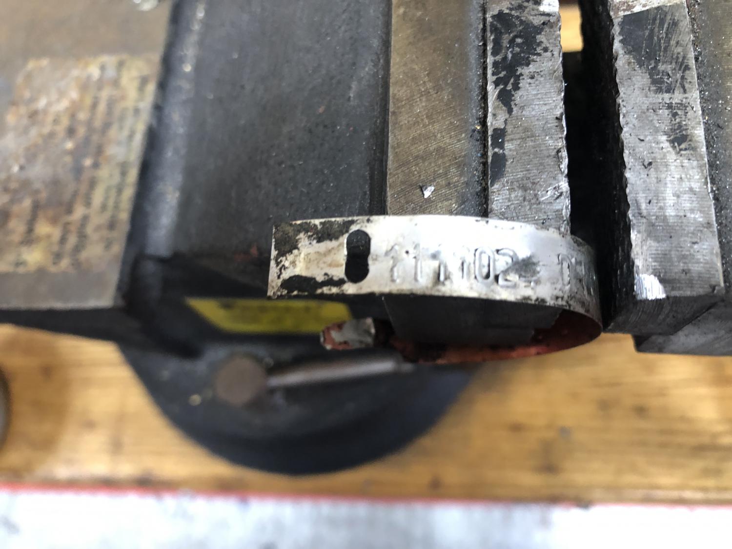

Guys,im a pontiac guy and am trying to help a widow of a friend that seems to have a lot of Chevy stuff and I found this tach drive dizzy and need help of what its for and also a value.He left her with 4 classic non running car,(3 pontiacs).Would appreciate some help.Tom

Hi Tom. Anthony here.
I think there should be another number; should be seven digits in my experience.
Confirm and let us know. And sorry about your friend.

those numbers are on the little alu strap in the recess just under the tach drive.Its a iron dizzy.There is a 09 cast into it above the alu groove.The plate for the points has 2769047 which might be the patent number.Looks like a MS or SW on the vac can.Cant see any other numbers,looks very original.Tom

Youre missing a number in the tag. Should be 7 numbers. Pics would help. There are 3 corvette tach drive style distributors made in the 60s and early 70s. Cores prices for the 2 are 75 to 150.00 but if its a fuel injection distributor, it could be worth a grand or more. Like i Stated pics would help.

just looked in my pile, I believe you have a 63 fuel injection distributor!! Thats a good one if its 1111022.

Best I could do,if there is another number after the 2 I cant make it out,almost looks like maybe a small 4.Will show it to Anthony Wed.Tom

Looks like a 4.
