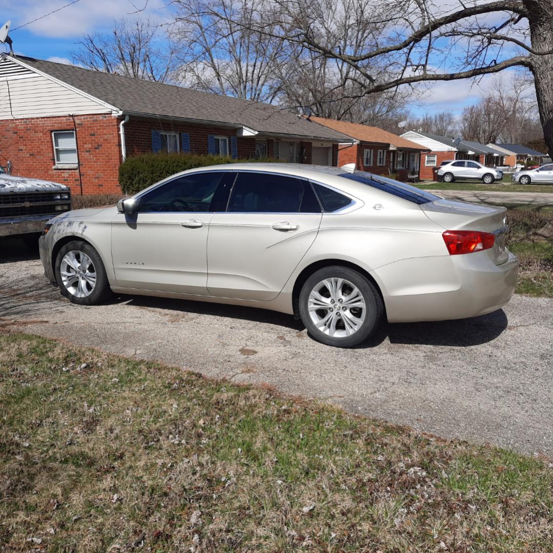

I just picked up this gem yesterday to serve as my new DD. To say it is in incredible condition would be an epic understatement. It's literally one of those "one owner little old lady" cars that's spent the vast majority of its life in a garage. It's a 2014 and only has 39K miles on it--when we put it up on a lift during vehicle inspection before I bought it, the undercarriage is damn near showroom fresh--there's barely even any surface rust on the exhaust system.
As such, I want to take every reasonable measure I can to preserve the cars condition, i.e. undercoating/rust-proofing and paint protection--but other than the old stand-by Ziebart, I don't know where to begin to look nor what the best latest technologies are.
Thoughts/advice please?

Fluid Film. Doesn't drip and doesn't smell bad. I can't seem to load a pic of the stuff.

Being born and raised in the rust belt I have tried just about all the rust preventative systems out on the market on all of my daily drivers
The latest one I have used seems to be the best in my opinion which is
https://www.woolwaxusa.com/Undercoat...r_ep_43-1.html
It has held up quite well thru rain and snow and still is “sticky” to the frame and underbody of my truck
I have a local distributor who applies it for me and am quite pleased with the results

Here’s a pic
