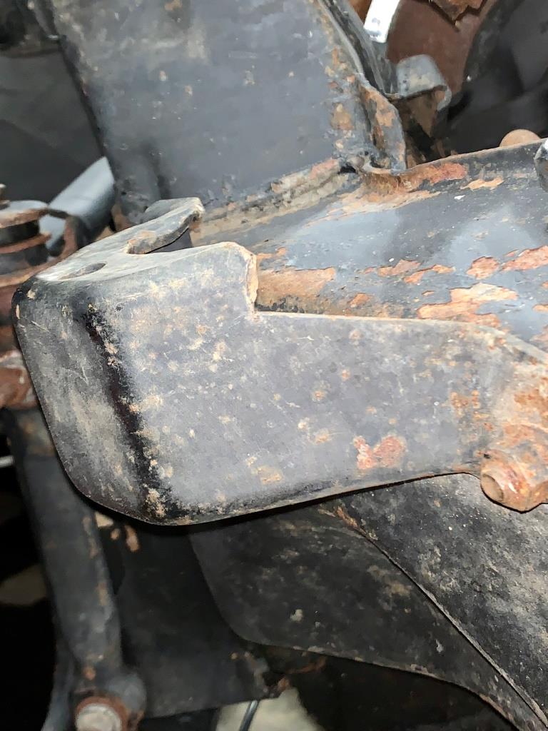

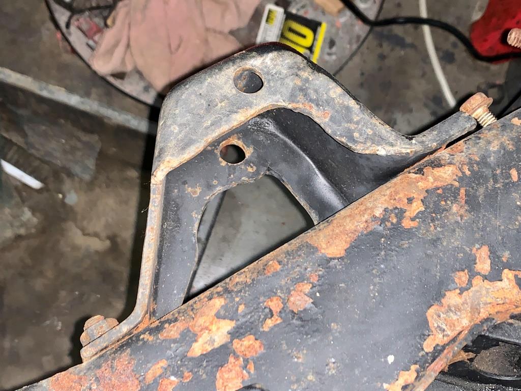

What is the build date of your car? IDK if it'll matter but curious is there might have been a change over point? Maybe not. My 12D LOS is has the sub off so I snagged some photos last night.

I looked at mine & they're just like Darrell's. NOS doesn't always mean assm line correct even if the judges approve of it. I'll find a better one to restore first.

My originals are in perfect condition and look just like what Darrell provided, so I guess there're 3892733-34.
I thought mine were wrong because of not having the reinforcement. Glad to know mine are correct and thank you guys!
