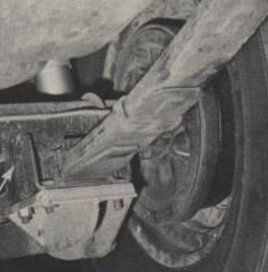

Firebird axles were sourced from Pontiac and appear to not have been painted after assembly. During final assembly, I believe the bottom of the axle was coated.
Camaro axles were sourced from Chevrolet and were painted after assembly. The brake drums were also painted; some overspray may be present on the PB cables. The pinion flange was masked and should not have paint. Brake lines were not installed and should not be painted.

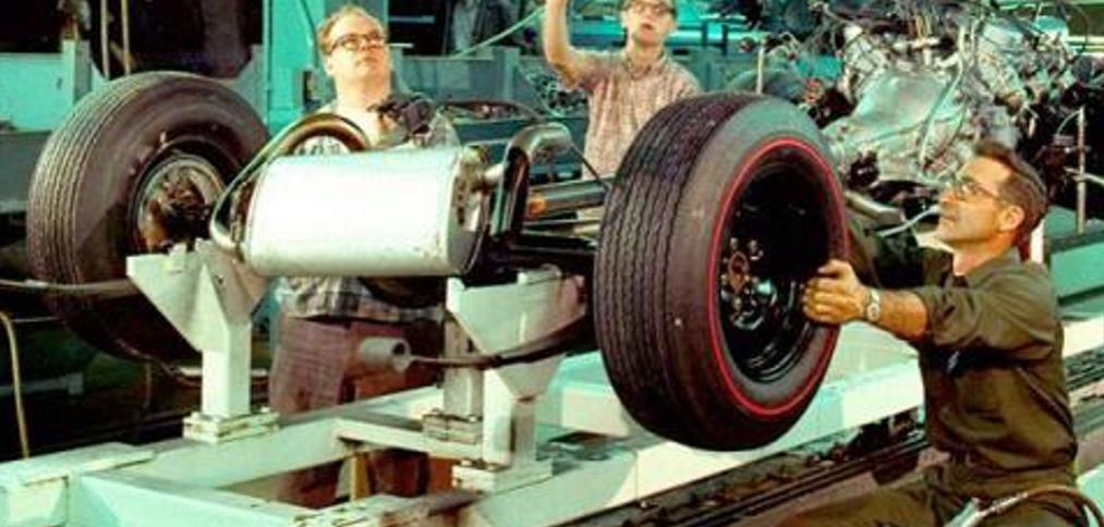

ZL-1 #3 road test photo.

Originally Posted by turbo69bird View Post
A freind and I were just discussing this the other day. Would appear on this car the black was sprayed after , coating the ends of the exhaust when hap hazardous eating from behind? As per the assembly manual the area around the brake drum ti backing plate is not supposed to get any paint in it so they stopped around the bolt in flange . Axles ends should be free of paint. This is my understanding anyway
There was a small paint booth before body drop where the completed chassis received a spattering of "chassis black".
The chassis black was a really thin, watery "paint" that was drizzled in the general direction of the chassis as it went by. The operator shot from above, so the top outboard surfaces received the most paint, with the bottom surfaces and inboard surfaces generally missing out because that would take too much effort to bend over or reach around 500 times per day.
(Oldsmobile in Lansing plant, shown as an example)
