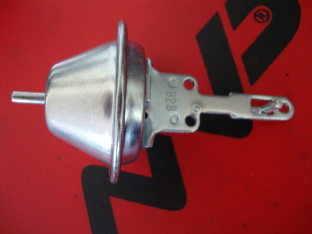

Looking for a new/nos “B28” vacuum advance can. These were listed under several different part numbers, most commonly known is the VC1810.
Pic for reference.
Thanks!

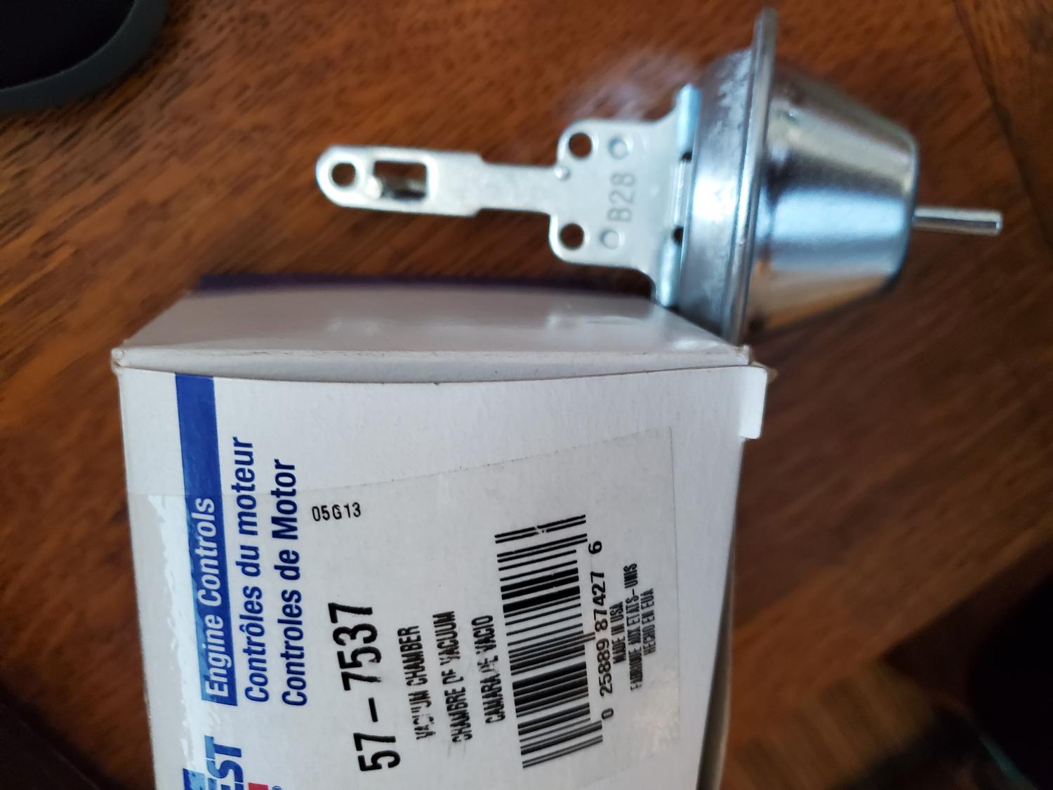

If you are looking for a correct specification can, use this......
https://www.corvettecentral.com/c2-6...5%26count%3d17

This can is fully deployed at 8hg like the B28?

Yes, I had checked it before installing. I'll add to that, I checked on the part number located on the box (as CC is buying it from someone else) and it was available from Rock Auto. I ordered a couple more just to have as I tend to work on these cars. Those did NOT deploy at 8". Just the one from CC

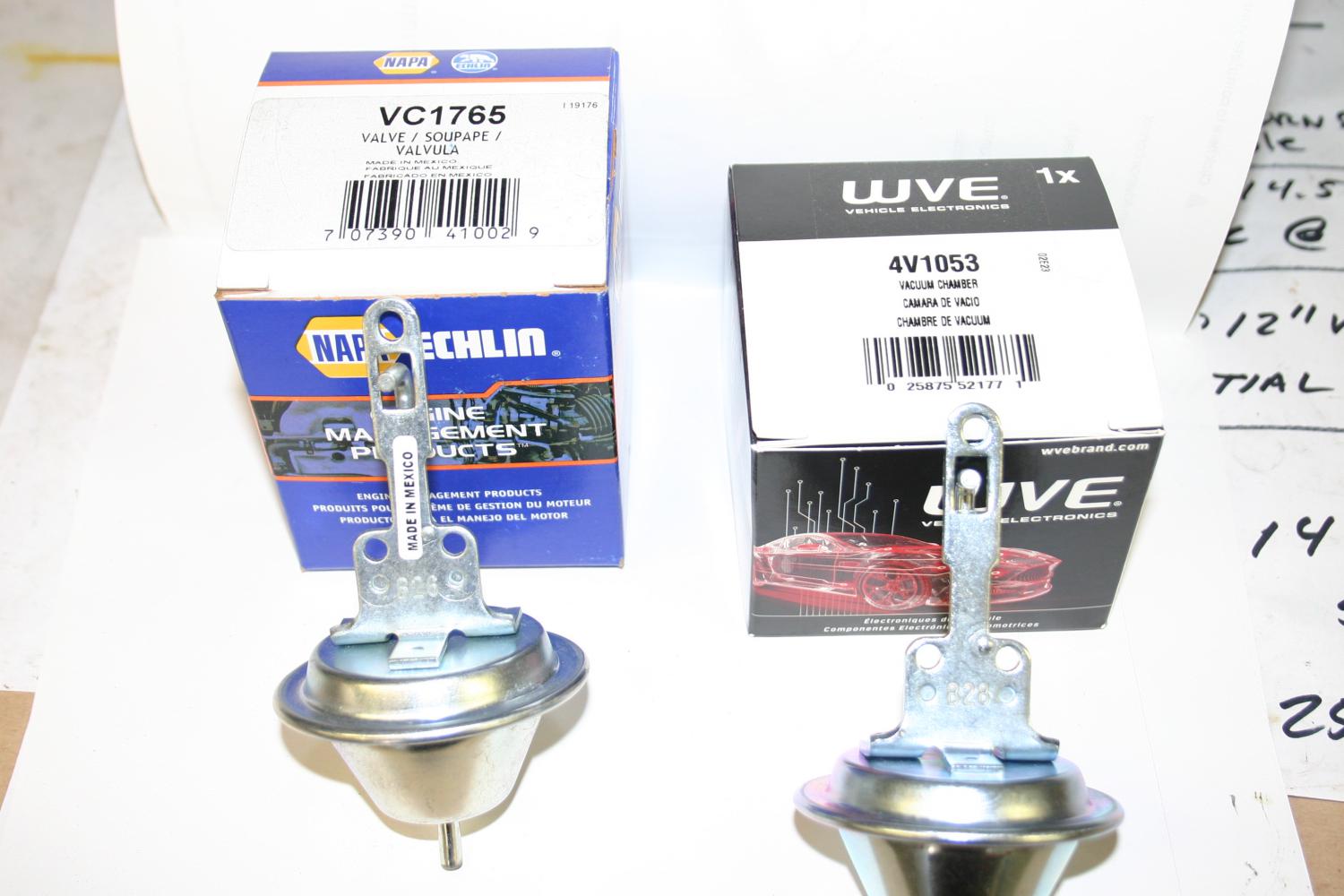

Tim, thank you for the info. I went ahead and ordered one. I ordered a WVE 4V1053 from RockAuto, which they lost as a replacement for a B28 and it does not fully deploy until 13hg.
What part number did you purchase from RockAuto?

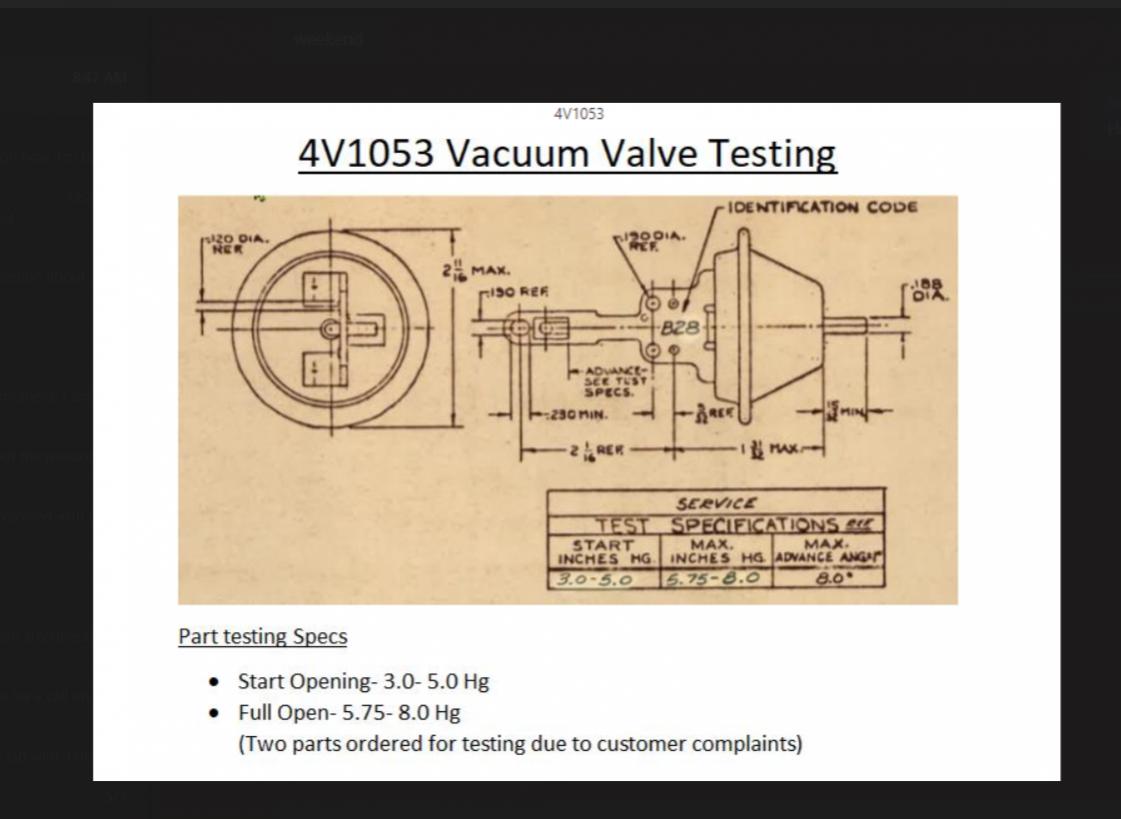

Default Info from WELLS
[email protected]
Tech Data on 4V1053 avail via Rockauto
