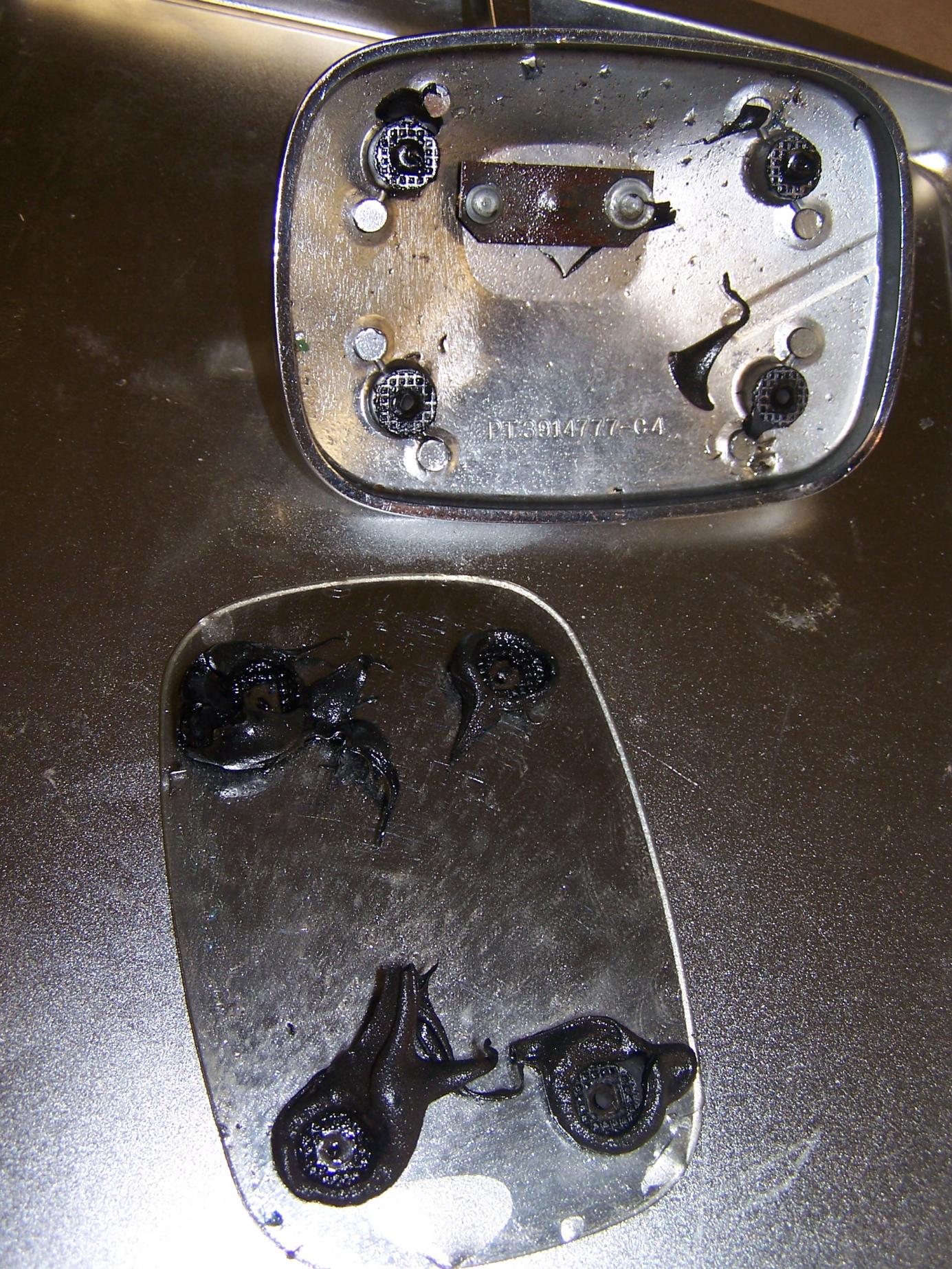

Jeff, I have done it by holding the mirror in a vise so the glass is facing up. Fill up the mirror head with lacquer thinner and let it sit for a day (the thinner should loosen up the adhesive). Gently pry the glass loose (I have also assisted this process using a heat gun on the backside of the mirror). You can also buy dated glass for the mirror from Paragon.

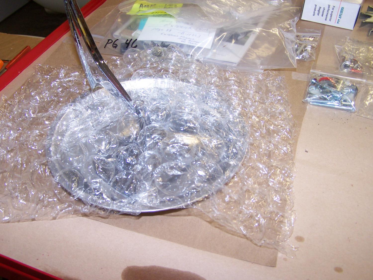

Photos of similar "soak" & remove

I did this and chipped my glass so let it soak good and be gentle. My adhesive was tough
