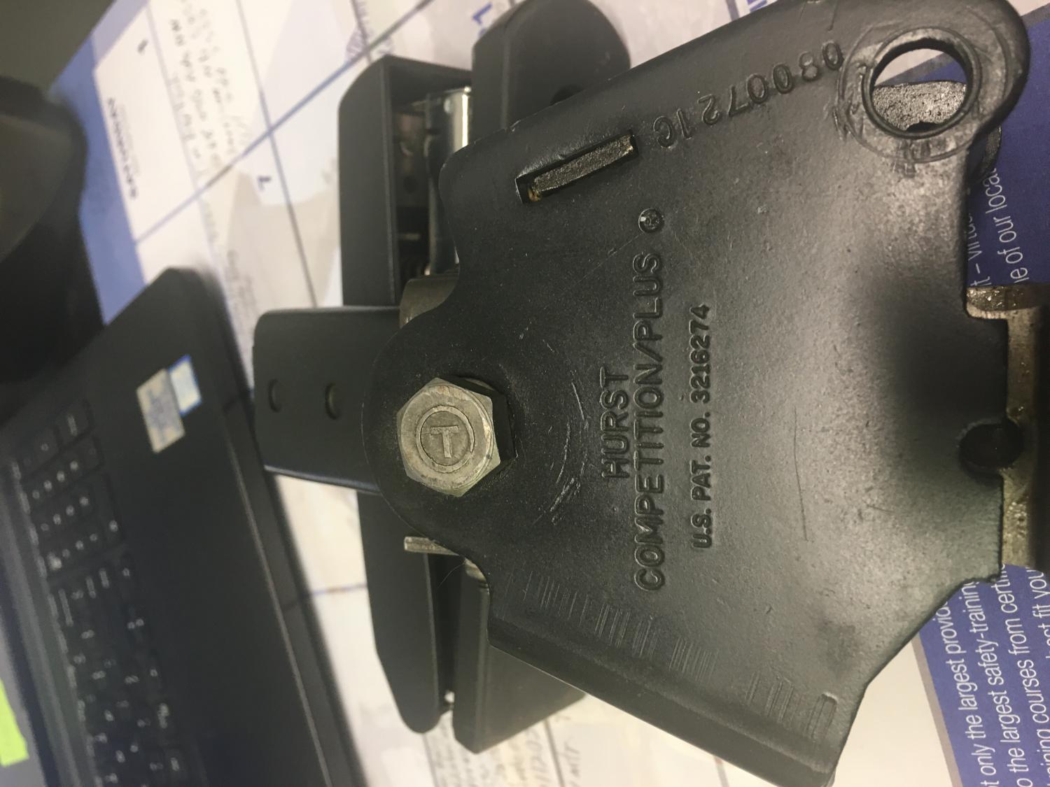

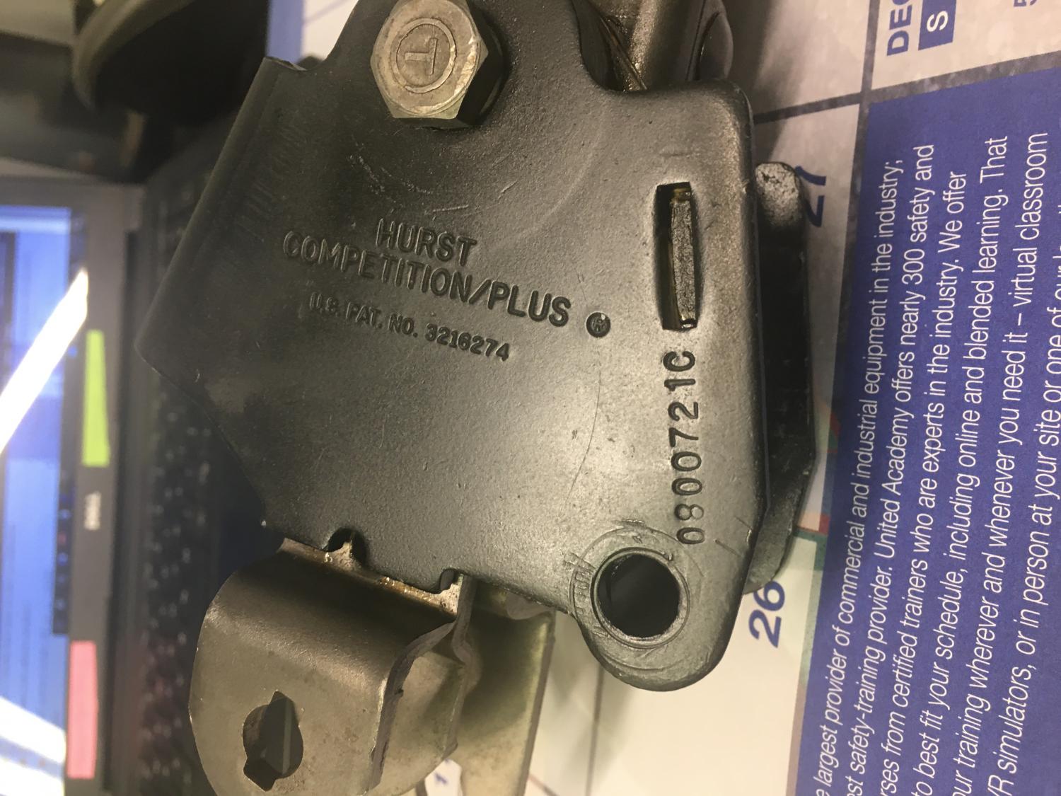

Is this Hurst shifter for a Camaro?

It's for a late 1970, early 1971 F-body...
Hope this helps... Crash

If you are asking if it is an original Hurst for 1969 (assumed) Camaro then I don't think so. If you are asking if it will fit a Camaro then I can't answer that for certain without looking up the numbers.

date code looks like a 1980 Firebird or TA.
The shifter body was similar from 1970 to 1981 Firebird and 70 , 71 Camaro , but the chrome sticks had different numbers.

It is a 3138 original Hurst body with no bolt stops, but has late code and does not have an offset handle. It's for a second gen body type as suggested above.
FWIW...body alone w/o handle. Maybe price it in the $200-$300 range

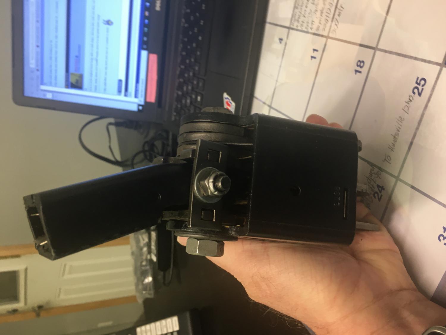

Is this what you refer to as an offset handle?

This photo would be an "Offset" handle
