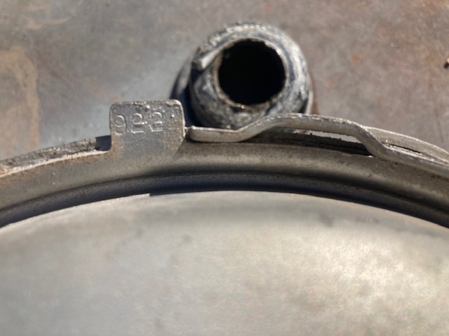

i'm trying to identify this booster. The tab has 922? and dated 345. Any help is appreciated. Thanks, Larry

9227 = '69 Firebird w/ Disc Brakes.
345 is the Julian date code for Dec. 11'th.

Looks like 9222 which appears to be 1969 Firebird...Joe
