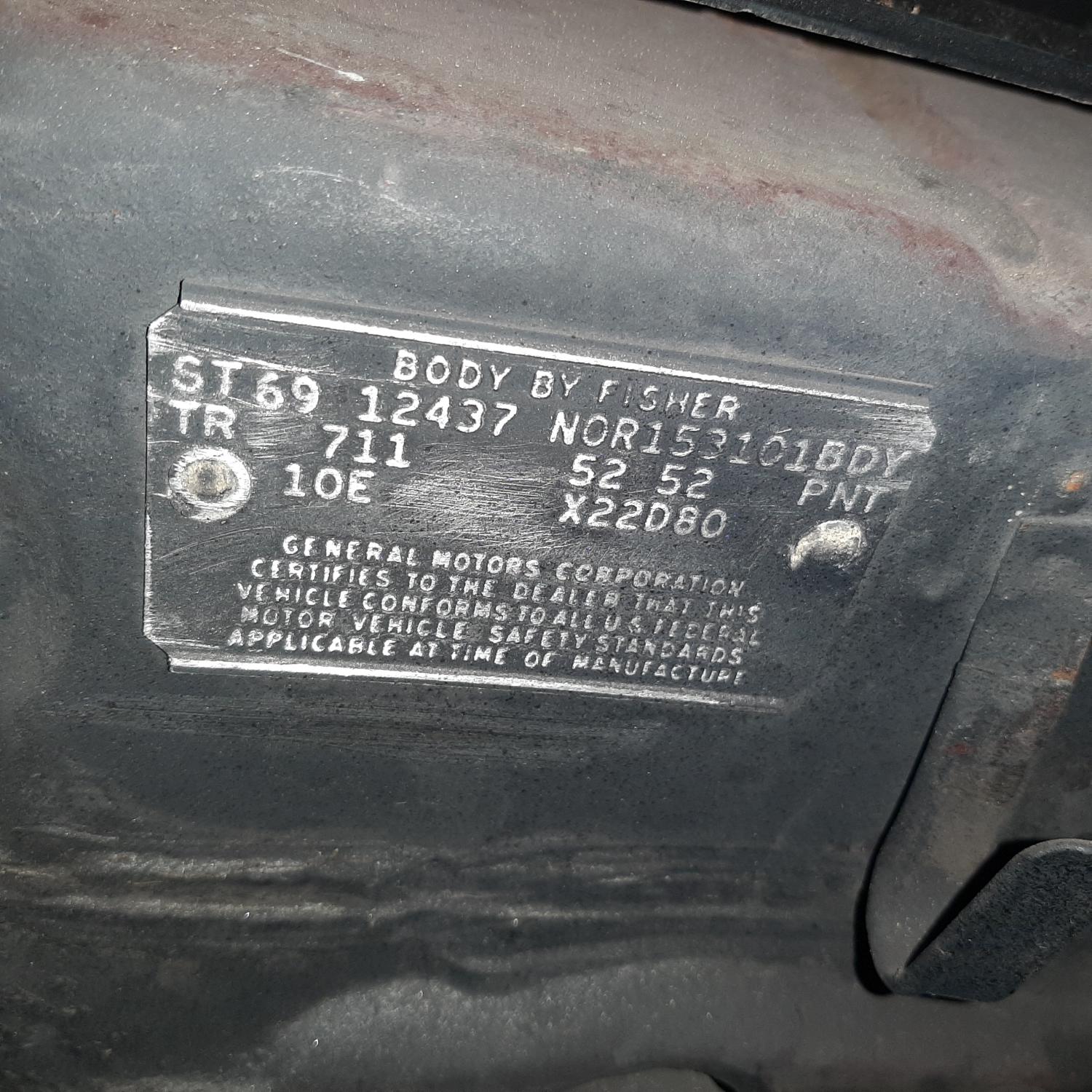

Could I please get you guys to weigh in on this one?

i assume the 10E is a very late build car? Is that a true assumption?

Wouldn't a 10E '69 car be a 5th week October '68 build? It would be a kinda early car.

Didn't X codes start showing up on 12B (second week of December) built cars?
The Xnn codes were a mid-1969 model addition to the Fisher Body cowl tags of Norwood-built Camaros, starting with the 12B (second week of December) build week.
http://www.camaros.org/numbers.shtml#XnnCodes

The build for the 1969 Camaro was extended from July 1969 to November 1969, because the 1970 Camaro was not ready for release.
http://www.camaros.org/geninfo.shtml

It is a late car. Is the tag legit? The rubbing of the rivets has me a little concerned but the tag shows no sign of being off the car other than that.
The tag looks good to me as mine is a 10E car as well. What is interesting to me is that you are located in Tennessee and I suspect my car came out of Murfreesboro. I have yet to get the NCRS report to confirm.

----Another mis-use of sandpaper on a TT!.....Bill S

VIN in the 705xxx-708xxx range?
