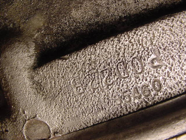

Attachments - The Supercar Registry P0D22B 0N535460.jpg P0D22 restamp 10N570762.jpg image.jpg Capture.JPG

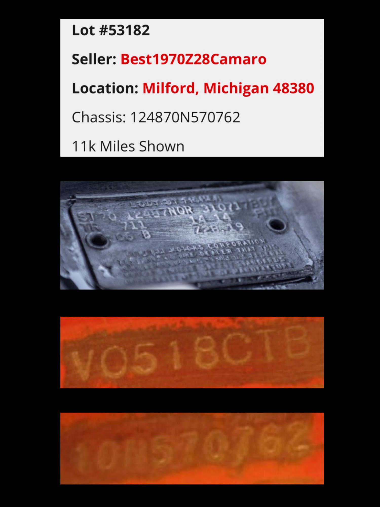

Too attentive is right w/ sanded TT also engine stampings look dental picked?
Eyeballs inspection best but info/pics/multi alterations suggest mileage claim may be suspect?
124870N570762

Norwood didn't stamp the VIN on the pad in '70.

^ I wondered that myself…

So is it a restamp? And vin was added?

I questioned the vin on the pad also. And didnt all 70 Z's have the 8 grand tach?
