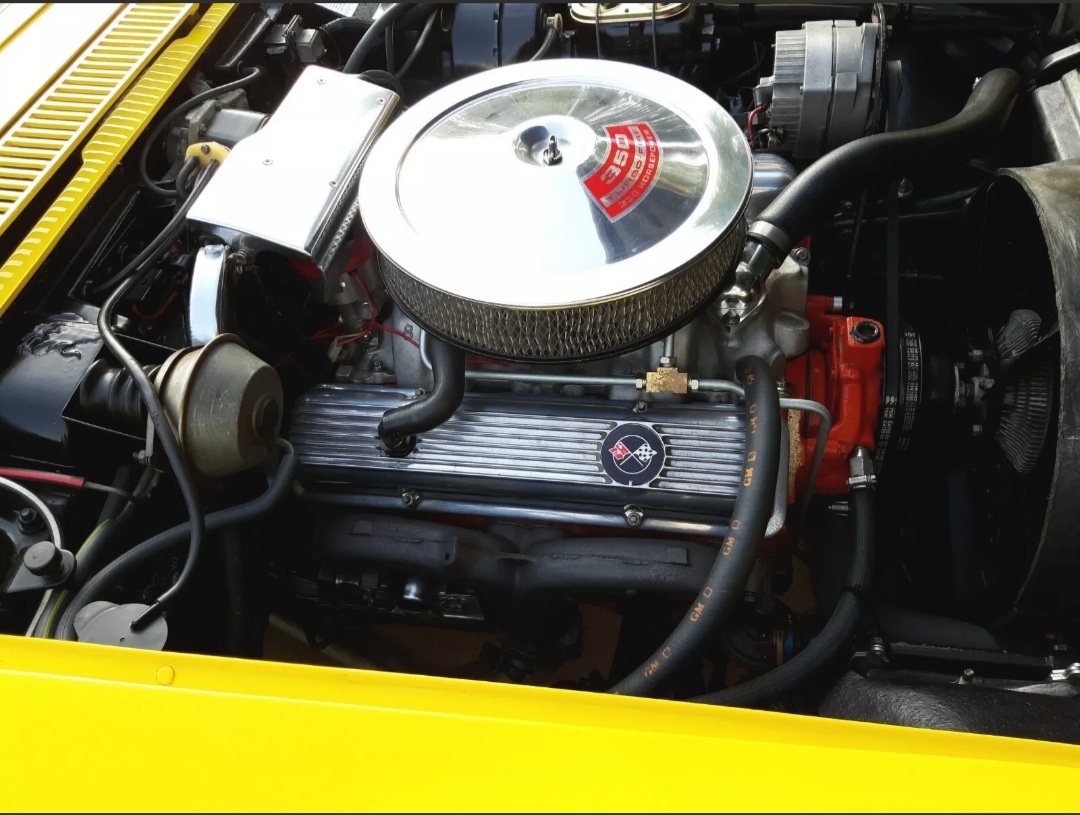

The son of the previous owner who had the restoration done took possession of the car toward the end, and along with changing the ignition, had assorted ARP bolts installed as well as chrome hold down and thermostat housing. What belongs in the manifold vacuum port with the blue anodized plug?

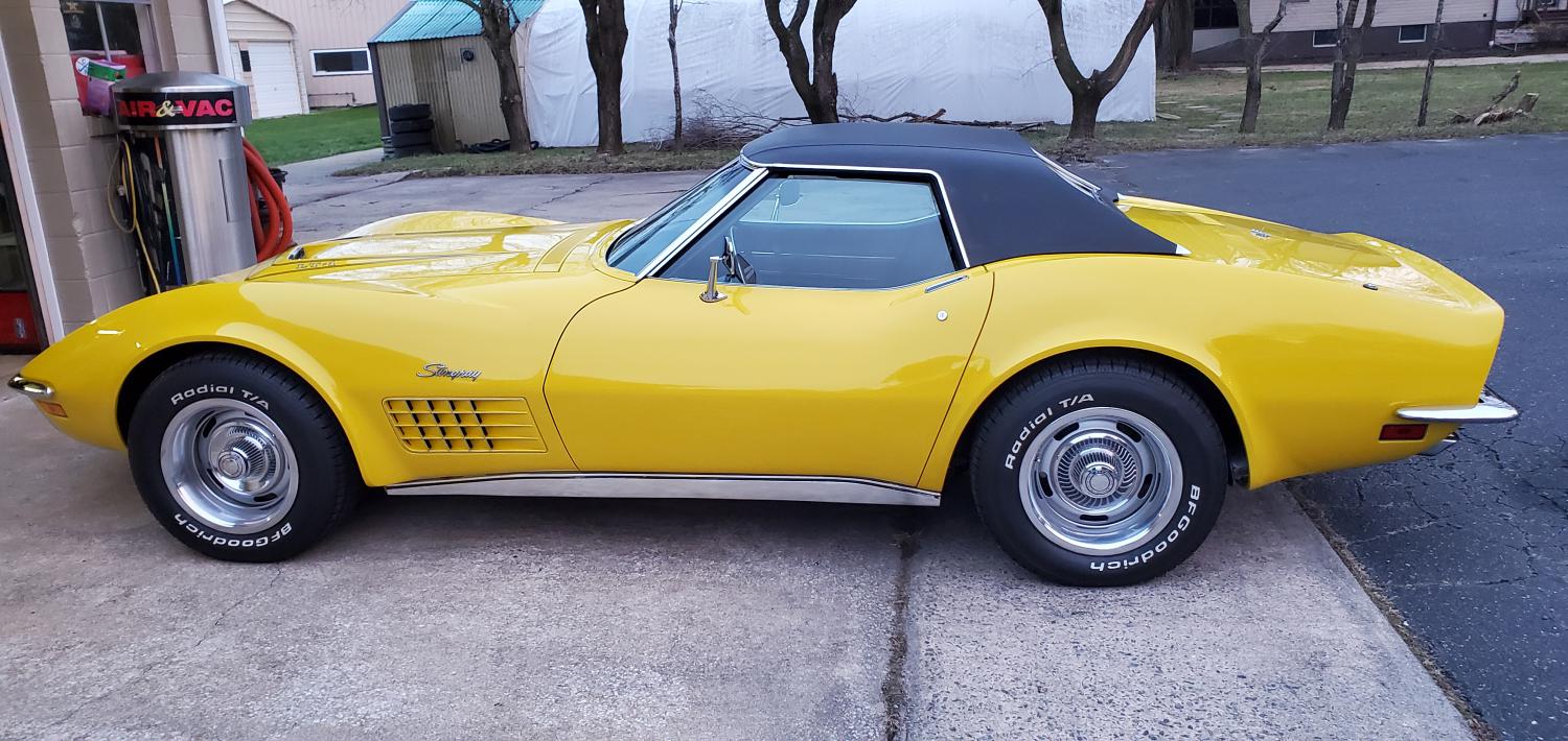

BTW... NICE LT1 Roadster I am guessing Sunflower Yellow - Black leather, vinyl covered hardtop tilt tele! Which trans and gear?
Build date between end of Nov and 2nd week of March?
It has a 5 port washer pump with 2 ports jumped - which is common for Nov - early march - Cars before the strike have headlamp washers. After the strike no washers but the pump was the same until mid march.
It's got a 71 LS6 fuel line and a later waterpump.
The correct waterpump for a 71-72 is a 3991399 and they are not very common, If not mistaken there are 4 dates they were made.
I believe that the passenger exhaust manifold is a Fuelie or off of an earlier car with the port for the choke tube.
The fuel line and block look just like a 69 -72 Z28 - along with the rear fuel line support.
Rear intake hole should have a fitting for the Power brakes and then another port for the vacuum take off.
Here are photos of the fitting and the pipe which bolts to the throttle cable bracket.
The first photo was taken the day the car arrived and The STAMP RITE bracket should have had an indented hex head screw not a pan head phillips. (it is correct now)

Car looks very complete. couple of "easy" fixes. wrong water pump and wrong carb distribution block.
WP easy to find, Paragon Vette parts has the right carb block.
TI stuff is coming down in price, if you are looking for a numbers matching car then call Fiedler. But Fbay has stuff all the time.
The ONLY way to get the LT1 to run properly , as an LT1 is to have the CORRECT distributor shaft and top piece for it. Those two pieces are the "secret" to getting the the car to run properly. Fixing the TI will not make this run properly until you have all the pieces....
