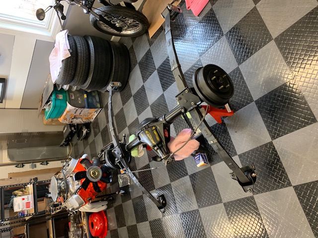

Looks like you made the right choice. My original springs were also centered and installed from the driver's side. The new ones were installed the same way. Took this picture yesterday.
