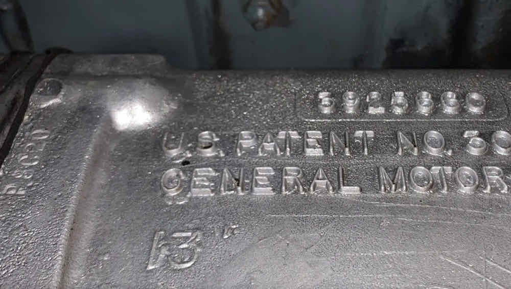

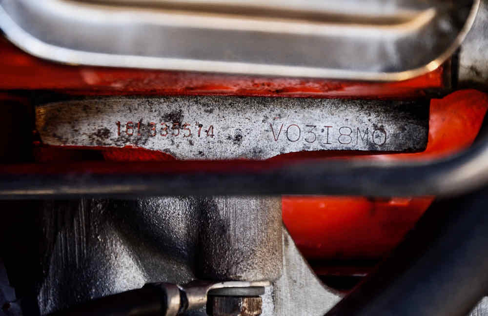

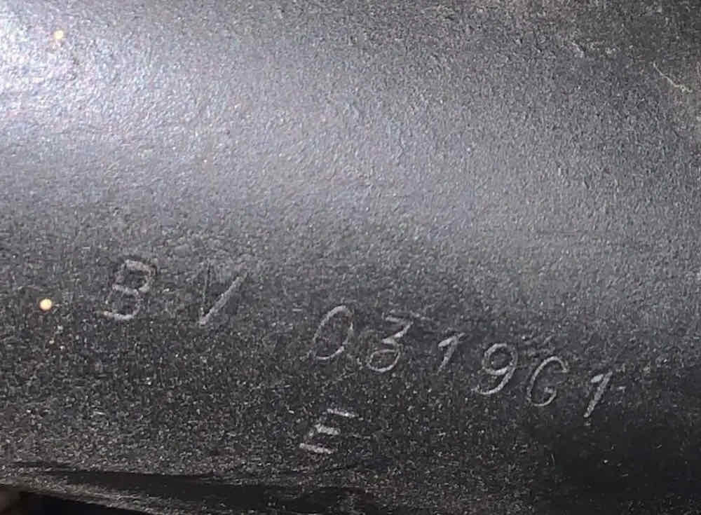

Might as well post these drivetrain stampings from the Ash Gold Z28 on Bring A Trailer and make note that the cowl plenum air cleaner housing is a fiberglass reproduction.
