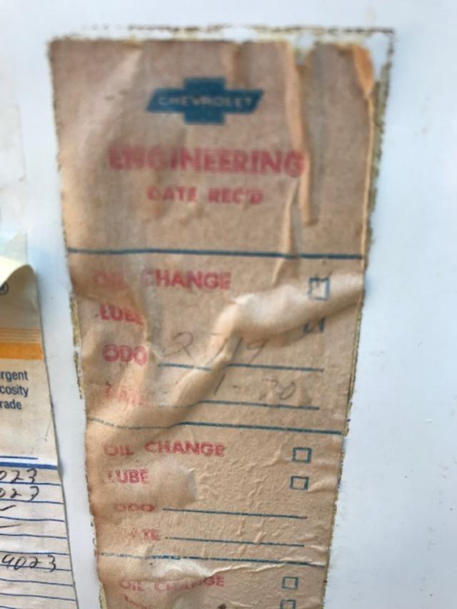

This is the eng in a 69 car that was a gm engineering test vechicle delivered to the chevrolet engineering center in michigan when new. Iam assuming it was installed by them since the car is pretty orig but was wondering what u guys think of the stamp? Its a #512 block Thanks.
Attachments - The Supercar Registry Webp.net-resizeimage (1).jpg eng pic.jpg door sticker.jpg

Didnt send for the ncrs docs yet but the p.o.p says chevrolet engineering center and this sticker is on the door which is pretty cool.

Very cool sticker.
