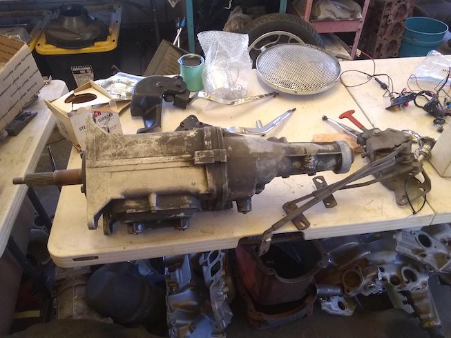

I've made a decision and decided to continue the journey with all of your help on this thread because I didn't want to hijack the Technical and Restoration Section. I have a zero mile 350/autogear 4 speed that will be in the car FOR NOW until I find the big block transplant for the car. However I have a lot of parts to sell to keep an eye on the classifieds.

-Will 1969 350 motor mounts the engine will actually sit low enough to clear a stock hood, will have to figure out the header situation
Update: I will use all Factory '67 Big block mounts, etc. I can still use flat hood.
-I have some 4 pistons on the way, I can always have them sleeved to prevent leaking. I have drums too.
Update: Using dated '69 brakes instead, it's what we would have pulled at the junkyard.
-Guldstrand mod for suspension (please make recommendation on springs/shocks for big block)
Update: No Guldstrand mod
-Brake/Fuel Lines ( I have brand new stainless sets, was stainless available back then? if not I can sell these too)
Update: Using stock steel lines, stainless is difficult to seat
-Would it be cooler to run a manual disc/drum master cylinder? (going to run power brakes, just acquired the master cylinder thanks Anthony)
Needed Parts List (Please inform me of anything I'm missing!)
-Complete running big block preferably with accessories still attached
(Snowflake heads a must)
Update: Big Block being built, NOS 077 Heads
Update: Engine Done. studded 2 bolt 454, 077 heads, 198 intake, 4296 carb
-Front springs and shocks
(Still need recommendation)
Update: Moog CS638 springs, kyb shocks painted gret)

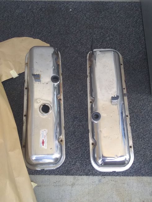

Only thing I would change is the heater core. After i traded my first Z/28 to my brother in 1972 or 73 he put a 427 in it. The MT valve cover actually touched the heater hose fitting.
Frankly, if you have a SB heater cover, you already have the right cover. Just punch two holes for the BB heater core. Just not worth the head ache.

-Valve Covers
