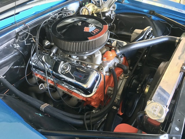

What are you guys doing to recondition your manifolds? I'm cleaning up the extremely nice 402 manifolds before I reinstall the motor in my '71 Impala...it's a low mile CA car so there's just a light coating of surface rust to deal with. I remember using Calyx back in the day but curious what you guys prefer in 2020.

Attachments - The Supercar Registry Passenger side engine assembled with manifolds.jpg exhaust manifold.jpg 53665820-9A0A-468E-A135-07330A9F6859.jpeg 3AD33534-4610-4CDE-AEE1-9A6D1A02DD4D.jpeg
