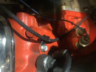

You did the same thing I did...chasing the correct clip. Here you go, a pic of mine in use.
