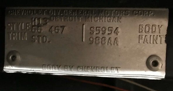

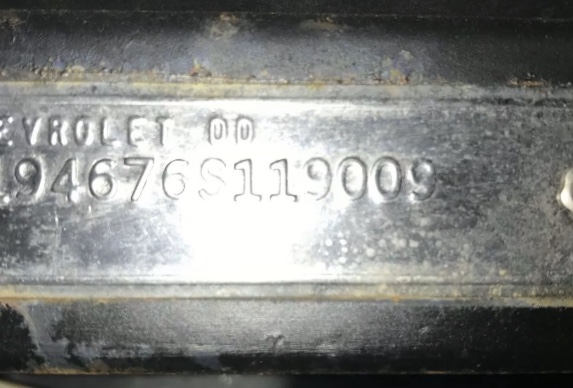

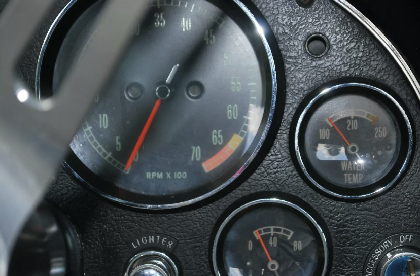

I contacted the seller asking about documentation... His reply:
“nothing but the vin and trim tag. it has the heavy duty sway bar, tach and oil gauge for 427 car also steel oil line and the indented cross member under harmonic balancer. I had it looked at by a guy that knows a lot about big block vettes he says pretty sure its the real deal.”

----All cross members in 1966 had the indent in the front crossmember. That change came fairly early in 1965 when they found out that the 396 harmonic balancer couldn't be removed without raising the engine up off it's mounts......Bill S

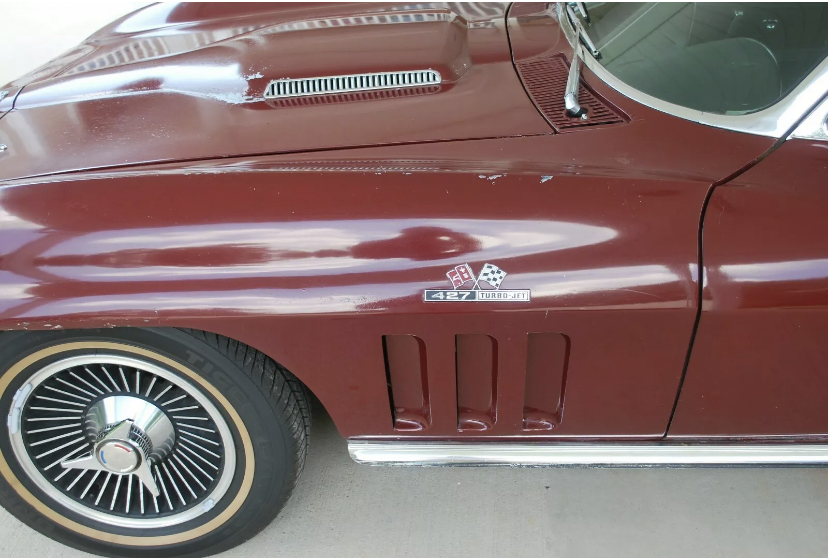

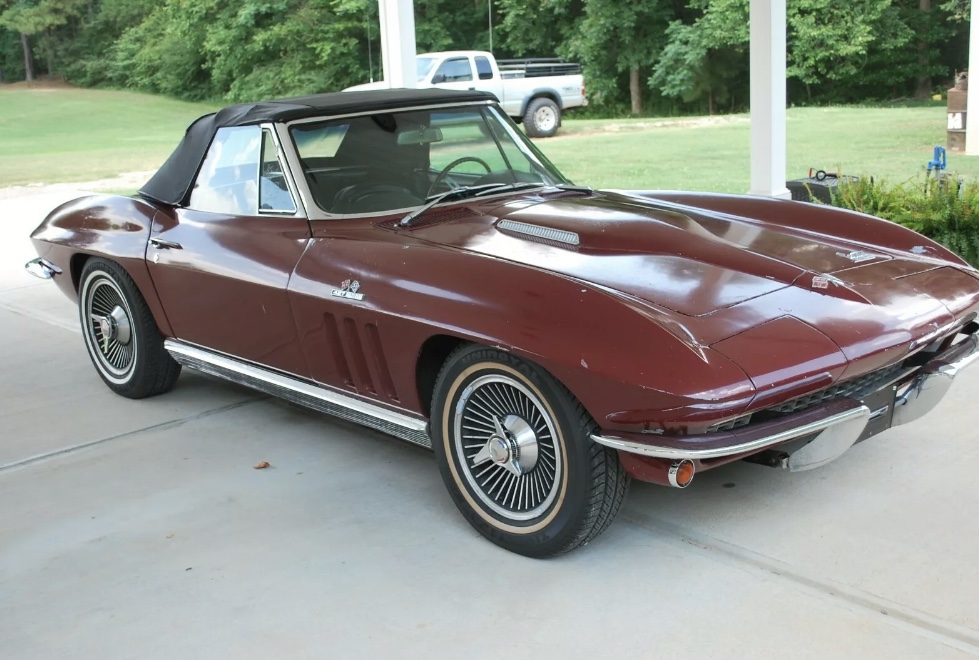

Bottom side spray bombed black, something funky up with the rear sway bar, NOM just to name a few. Something looks odd about the paint on the nose also but that might be poor pictures.
