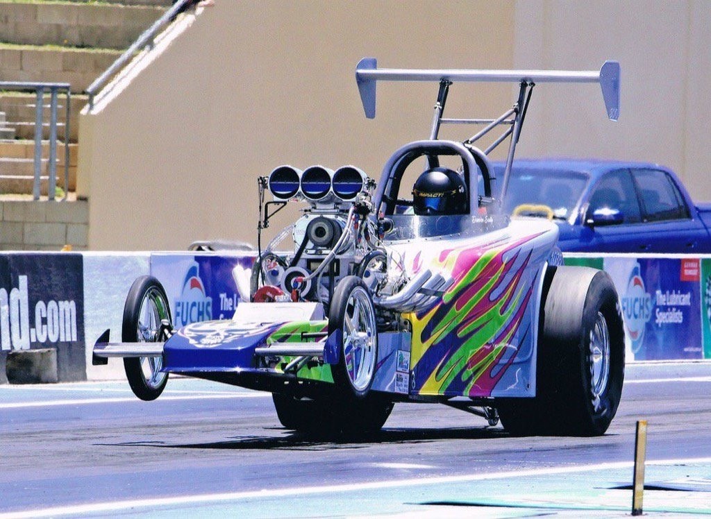

I had two different RCD front drive set ups on my race car and both of those were adjustable to some degree. I can get a better pic later for you if you would like.

Sweet! Thanks for that pic, Damien. Yes, I’d like to see a closer pic.
