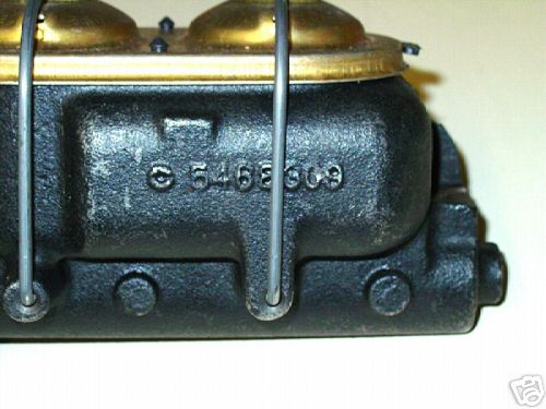

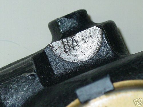

I've seen them out there with julian dates in the 300s. Here's an NOS one I saw on ebay about 15 years ago. Notice a faint stamp of 335 upside down next to the BA stamp. Haven't seen something like that before or since then. You can't see the cast julian date on this one, but I'm betting the 335 is a manufacturing date? Phil
