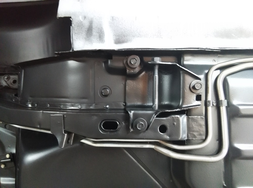

I had to replace the floor and there is no hole for the clip need to know the location & style clamp & bolt this is on a 69 Camaro

My 69 Camaro is on a body cart right now & I could probably tell you but I can't tell where the picture was taken. I'll send you a PM with my number if you want to call tomorrow....Joe

I recognize where this area is, Joe. It is where the line (and floor pan) kick up to accommodate the rear end. This is on the left side. You can see the left (dual) exhaust hanger in the picture. This is the rear brake line and this view is close to where the rear line terminates and makes a pigtail into the rubber flex line. Likewise, I can provide pictures mycar is on the lift.

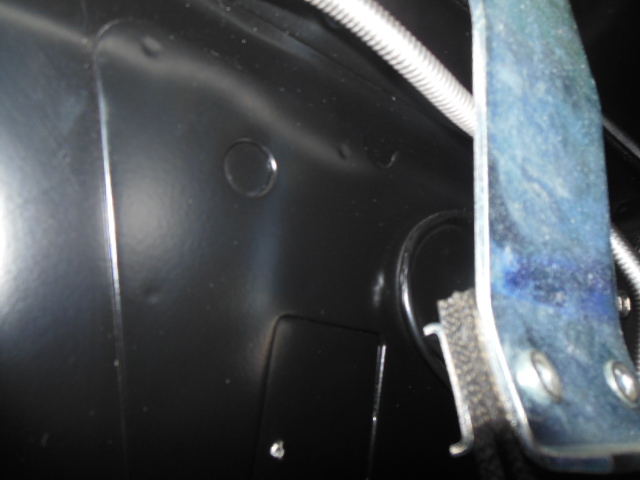

Here's a pic for you of mine.

Here's a better pic along with the fuel lines if it helps.

thanks for all the help that's just what I needed
