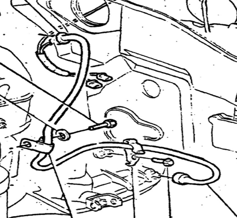

need help identifying this accessory wire on my 1969 Chevelle SS convertible
the wire goes from the fuse box to a connector under the dash then into the engine compartment thru a hole located next to the wiper motor. Any help would be greatly appreciated .

the two wires with the grommet are for the switch attached to the gas pedal. pics from the assembly manual below. hope this helps andy

Thank you so much - I cant believe I didn't figure that out. the turbo 400 kickdown harness!!!!!!

Here is a good picture of the switch and wires connected
