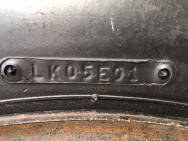

Hoping to decode the tire manufacture date, anyone know? Thanks

Oct 1968 - GAD Plant..... I think

Thanks again Dave, that makes sense, the wheel is dated Oct 68.

Same thing I came up with. L=68, K=10th month and 5=plant

What would UA02086 be? Thank you, Joe

U=1969, 8=August, 2=plant (CAL)
