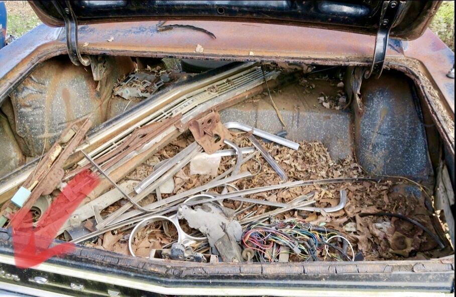

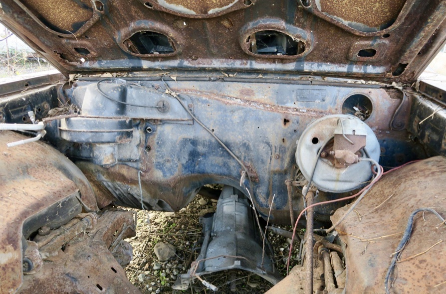

I'm now the New owner of the 66 Chevelle that was posted in the E-bay add section. Factory Black car bought New from BILL ALLEN Chevrolet. Anyoneone know anything on this Dealership?

The car has AC so it can’t be an L78. It was either an L35 or L34.
