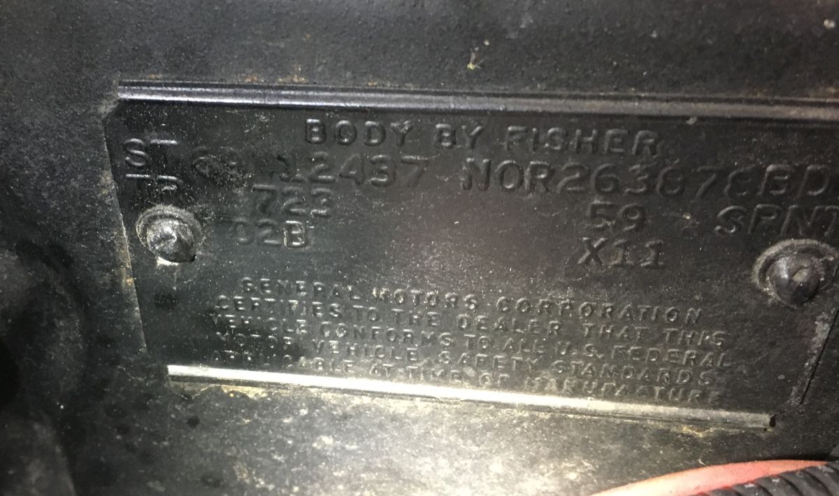

Here is a picture of the Data Plate anything on this help or hurt it?
I really do thank everyone for their help with this.
Old 11-19-2018, 10:01 PM
JKZ27 JKZ27 is offline
Join Date: Jul 2017
Location: Maryland
Posts: 196
Thanks: 46
Thanked 31 Times in 25 Posts
Can you post a pic of the engine stamp? If it's the original VIN stamped engine, suffix codes: HE, HB, HA would indicate L48 350 used in SS.

Old 11-26-2018, 10:04 PM
camarojoe's Avatar
Join Date: Sep 2003
Posts: 5,313
Thanks: 255
Thanked 295 Times in 126 Posts
Post a pic of the entire underhood area. I'm betting it's not an SS.
