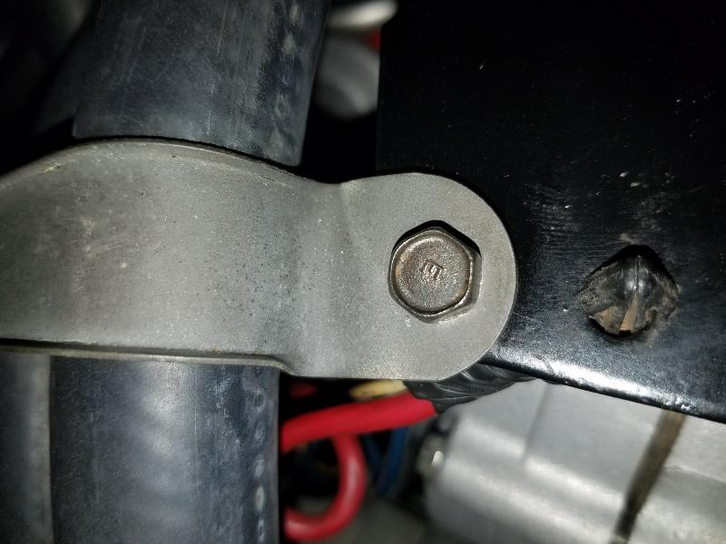

Heres the head and the notch out of the side

Great re; photo Bill, I might hijack that one
And on a side note I have seen a few survivor's without the clamp, along with no threads in he hole.
