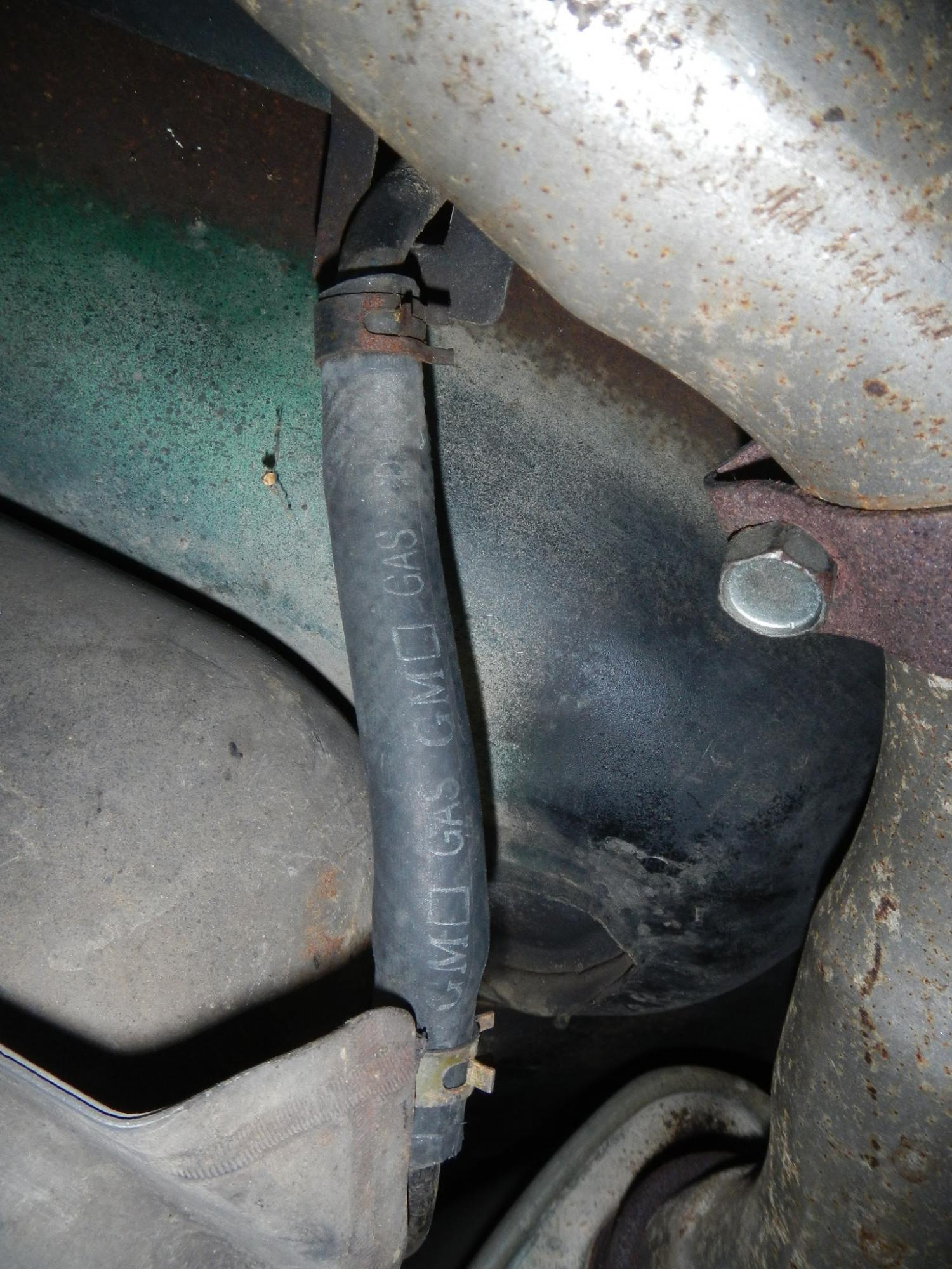

This is the hose from tank to line on Stefanos 69 Z survivor

I used some of the repop GM gas hose on my Z. It has been on about 4 years and was so hard I threw it away.
Bill

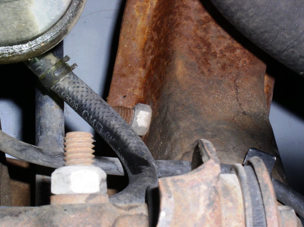

This fuel hose is on a 05A Camaro...Joe
