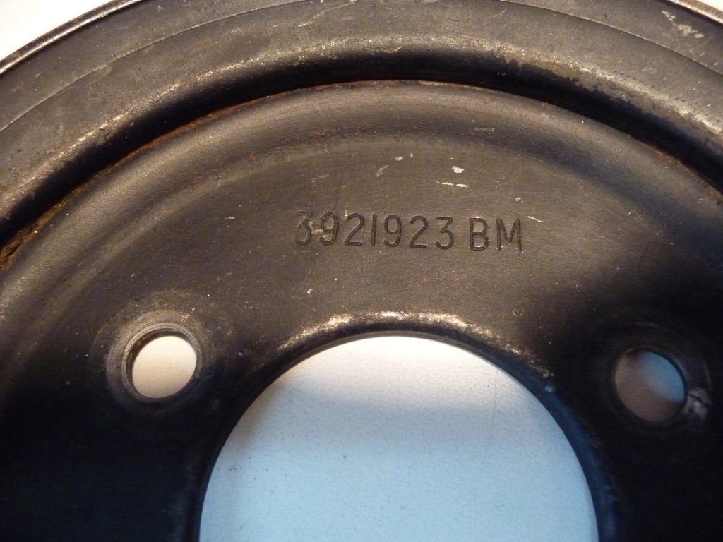

I have looked this part number and every thing I see is a double groove...... not single ???? Any help on this ????? thanks joe

I've seen the second groove machine/cut off plenty of pulleys.

This is not cut at all

Post a pic of it, if you have it. I have had one of these for years, same p/n and wondered if it was orig or not. I cannot see Chevy having the same for a single and double groove pulley, but who knows for sure

Here are some pics As you see it has not been machined thanks joe

...5291 is the BB double/deep groove pulley p/n

The early cars had driver pulleys for the power steering cars. Ive never seen a single groove 923 . No way the single groove is a replacement it would have to be the other way around
