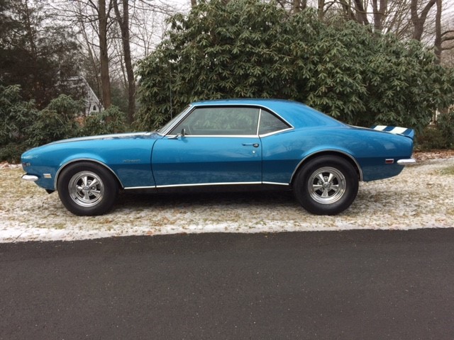

I had to move cars around today and took a photo while Camaro was outside. I put Cragars on it and find that 7.10-15 on the front don't come close to fitting. Anyone know what size tire that will work on the front? The Cragars are 4" wide I believe. Thanks

I bought the 5.60.15 Firestone Pie Crust for just that reason. They are 25.79 in diameter when many of the others are up in the 28 ranges and worried they would rub.

I have Firestone 7.10 x15 on a 4' Cragar on my 67, im thinking they are 27' tall and they fit fine , I'm assuming they rub when you turn ? FWIW they Looks perfect !!! Pretty Car !!!

Fronts are Moroso 7.10-15 and are about 27" tall. They rub really bad when I turn. I think I have to drop to something around 26" tall

I have 165R15 on 67 camaro with early style Cragar 15x4 SS. No rubbing issues.
