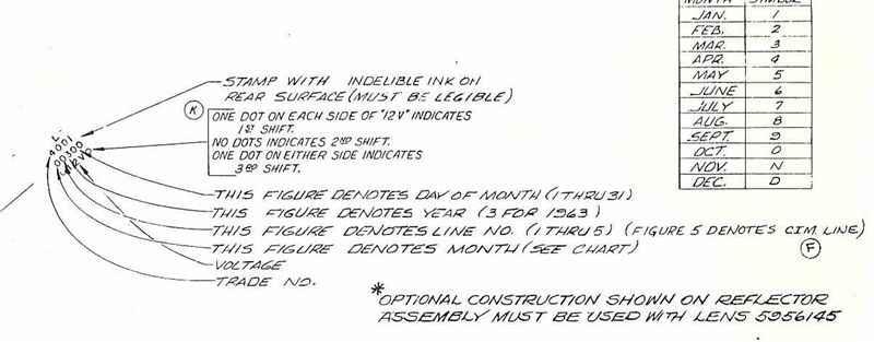

Does anyone know what the Original headlamps for a 1969 Nova are?

T-3

Ink stamps on the upper rear side of the bulbs can be washed off very easily, so be careful when cleaning.
