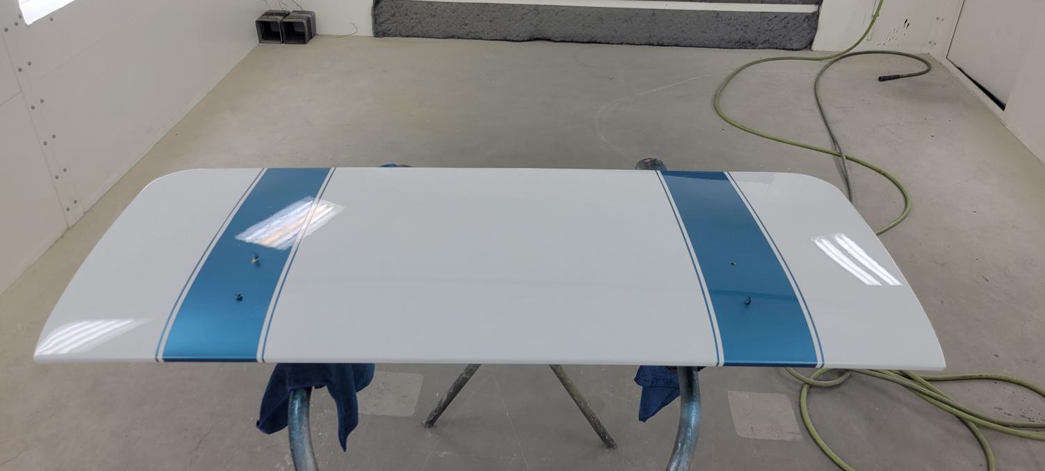

How do I ID the below deck lid as being GM or aftermarket repro ???
Could not find date code as shown in another current deck lid thread

I still need to look/find the date....I "think" this has never
been on a car, as exterior is still black primer.
Nothing in the linked article pointed out how the repro deck lids differ ????

I'm still wanting to determine what I have with my first gen Camaro deck lid ???
Cant see date anywhere
Doesnt have any "hole" like the service replacement.....
Seems like a new/never installed but I cant prove anything !!!!!!

Has no stamped numbers/letters that I can see

Date stamped will be in the area of the link posted previously. More than likely filled from heavy paint. But to narrow it down that lid was used between Jan-Feb to around April-May. Reasoning is it appears to have the TA holes as well as the tabs at the lip of the lid.

Do the repros have the TA holes ?

repro lid I had for my 69 bird did not have TA holes I did find a super clean original lid that did so I sold repro lid
I needed the holes

Yes but I have not seen a repo that has the tabs also. Not saying there isn’t any but I have not seen them.

I have a repro with smallish tabs (more like a raised bump) unlike my original deck lid that has bigger real tabs.
I also stated previously that all GM deck lids have welded nuts visible inside the bolt holes unless someone can prove me wrong. https://www.yenko.net/forum/showthread.php?t=143742
