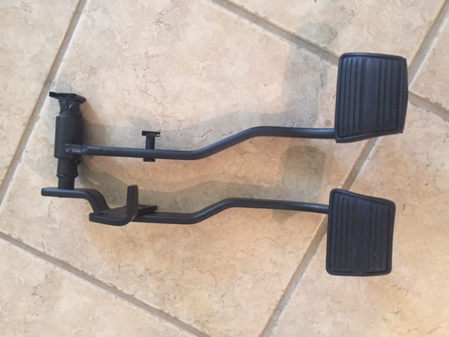

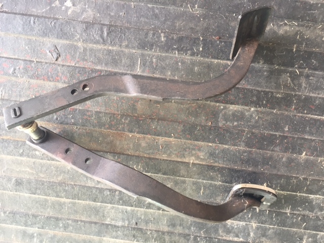

Can Anyone ID these assemblies ? I know they are not Skylark/ Chevelle..
Thanks
DL

top is chevelle and its unique to chevelle
BOP uses a bolt and nut for the cross pin..chevelle its a welded pin with a clip
bottom looks like F or X body to me..theres a few diffs in generations..and a ebay search would prob come up with a better ID...EDIT...a google sHows they match 69 Camaro..
