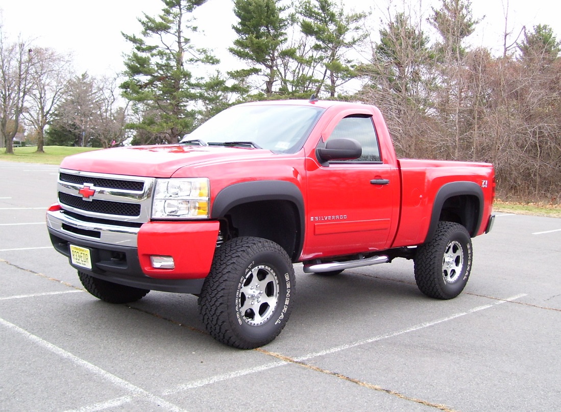

The lug pattern is the same on the 1500 4WD trucks. The newer trucks have larger calipers which require the 17, 18 or 20&quot; wheels and the older ones can run the 16&quot; wheels. If you go with taller tires, you can get a Diablosport tuner to change the tire size and make the speedo correct and the transmission will be fine. I have 35&quot; tires on my 2009. I went with 17 x 8 wheels with the stock backspacing to keep them from sticking out.
