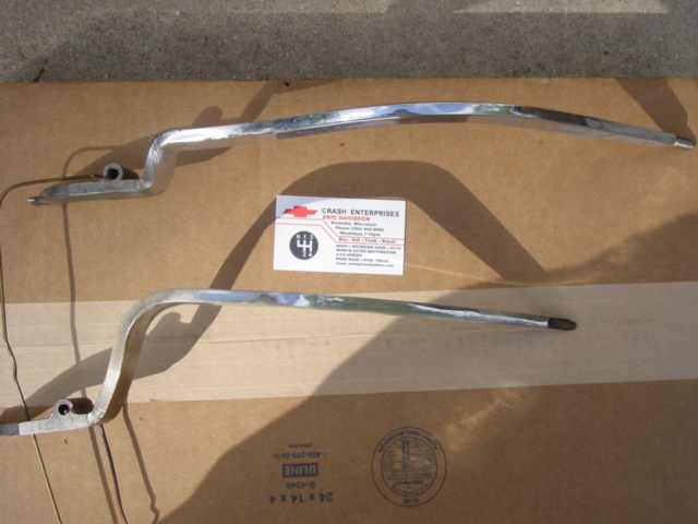

Tom, how do you tell the difference between a console shifter and a non console?

The biggest difference is the physical size of the shift handle....the bench seat unit is longer and taller. Console shifter will have a more upright aspect to the handle to make it work with the console setup.

Donnie...The console shifter kicks the handle over to the right so it comes up thru the center of the console. The non-console shifter is more straight up and comes thru the floor closer to your leg.
