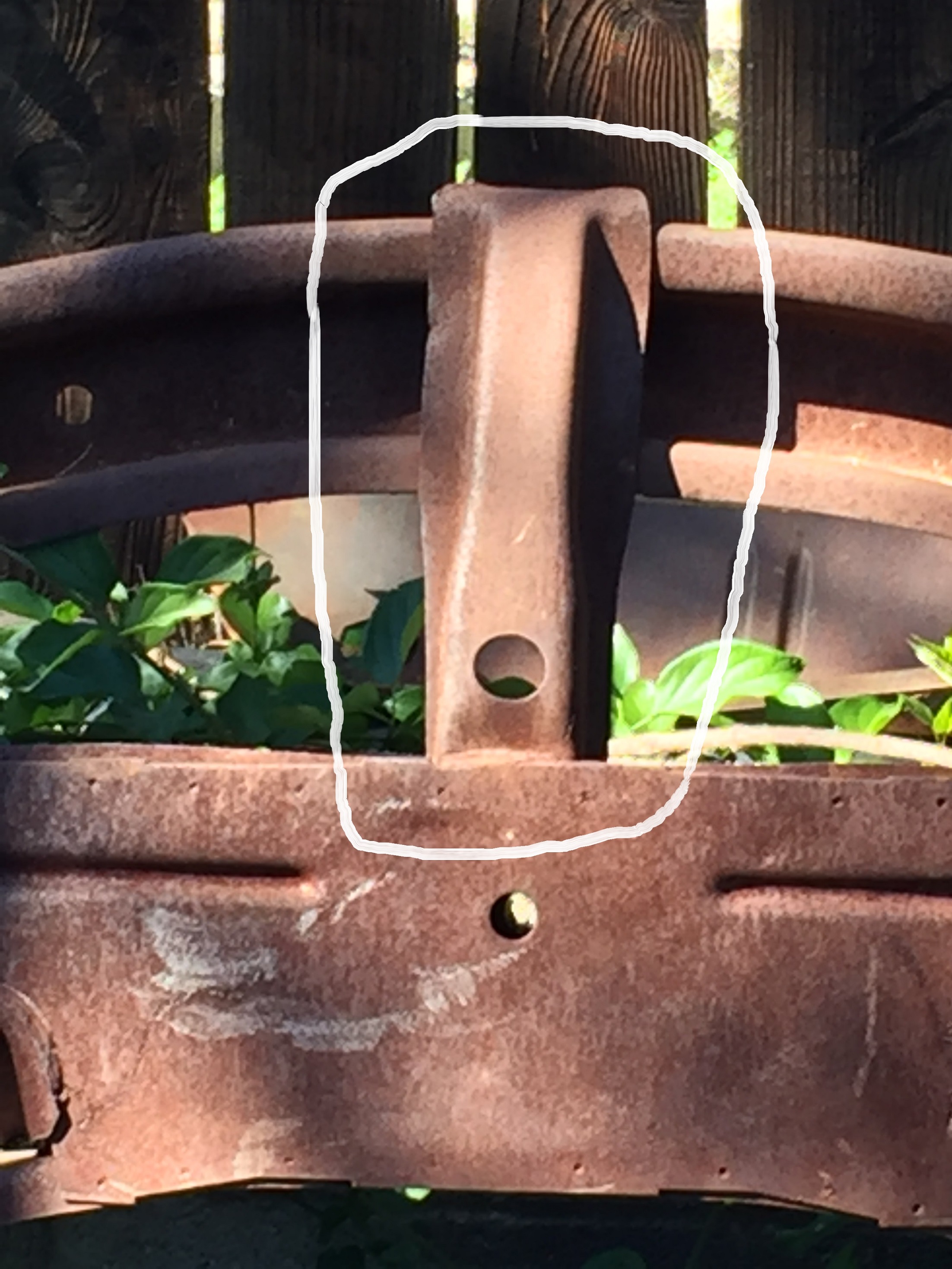

Does anyone reproduce this bracket? Mine is dented. Also open to a used one if someone has one. Thanks

You could heat it and straighten, I have had good luck in the past.

Take the bracket it and straighten the bracket[you can it get straighten in a vice off the subframe easy]. Then weld it back on. Also you can weld up the subframe,at the crack, on the lower left of the picture.
