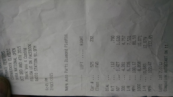

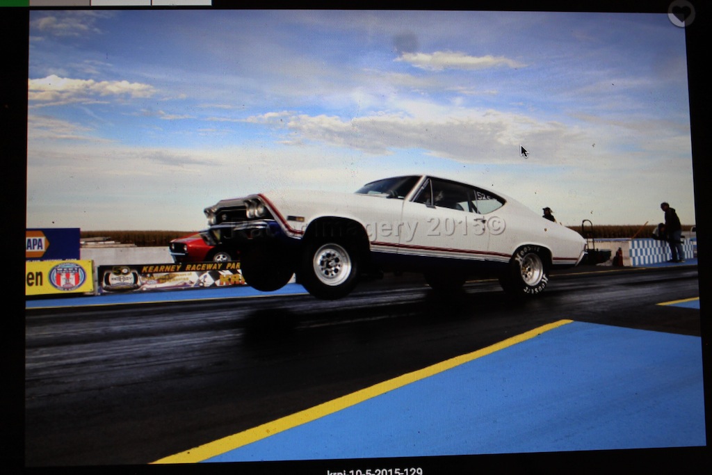

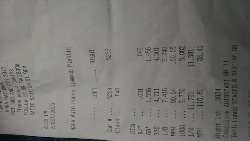

My goal was to build a smooth idle 9.3 compression 467 BBC with peanut port heads (236 castings) then put it in my 1968 Chevelle for a drag test, yes a real drag test. Some pictures as the build went along. The center piece of my build, notice the symbol.........that sure isn't a hump there!
