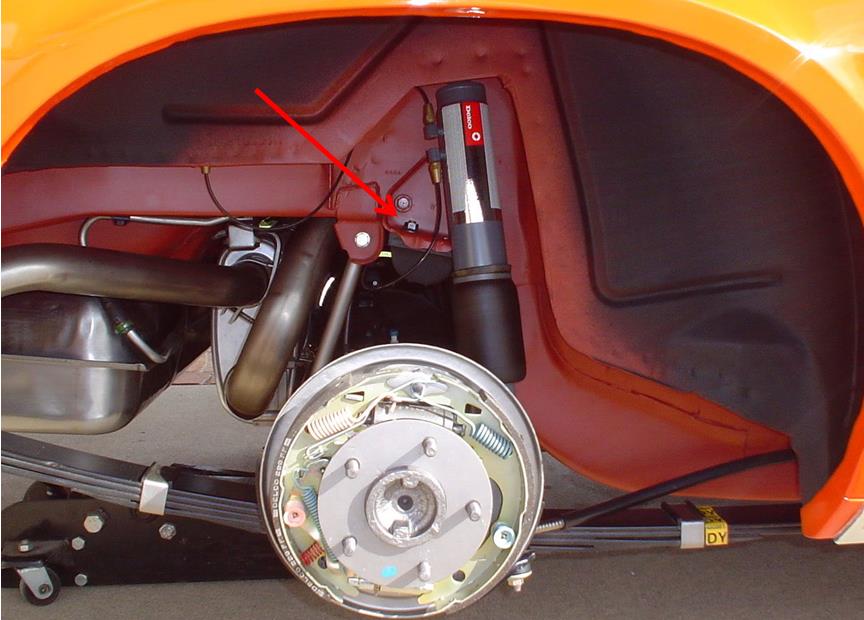

<div class="ubbcode-block"><div class="ubbcode-header">Originally Posted By: 70 ls6 convert</div><div class="ubbcode-body">just purchased a 1970 z28 it has a 3 piece spoiler heard some talk while back that this could mean copo 9796 any help would be much appreciated </div></div>
Post up a picture of your Axle snubbers the ones that bolt into the inner wheelhouse base.
