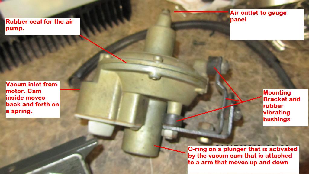

<span style="color: #FF0000"><span style="font-weight: bold">Well I brought the pump into work today and we put it on a vacum. It works but needed some lubrication. So I took it a part and cleaned out good and then Neolubed all the little parts that move and put grease on the o-rings and sealed it up good.
Hooked it back up to the pump and she is perring like kitten. </span></span>

<span style="font-size: 17pt">Nicely done Andy. Great descriptive fotos. We like those!</span> [img]<<GRAEMLIN_URL>>/laugh.gif[/img]

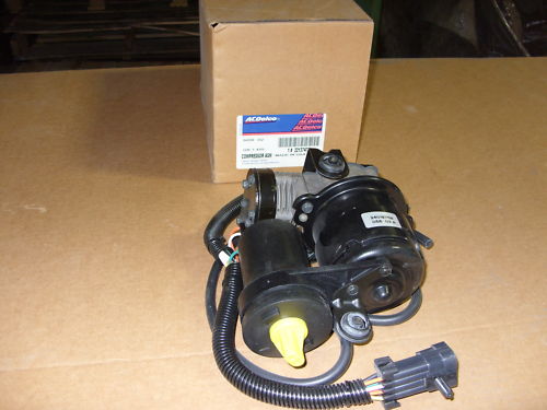

<span style="color: #FF0000"><span style="font-weight: bold">I ordered this the other day off E-Bay. This should take care of the bags if the little vacum pump can't.</span></span>
