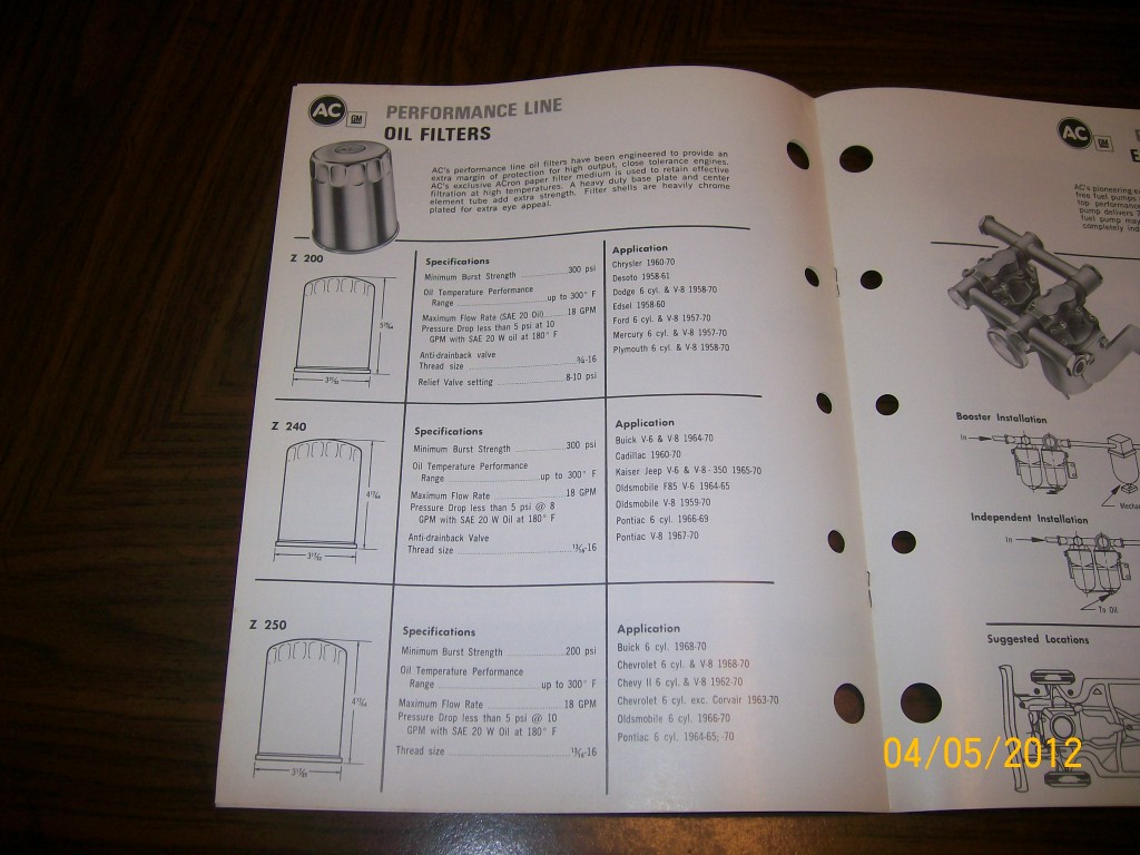

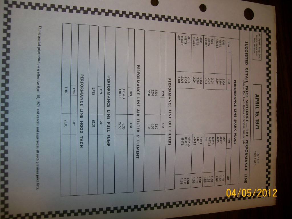

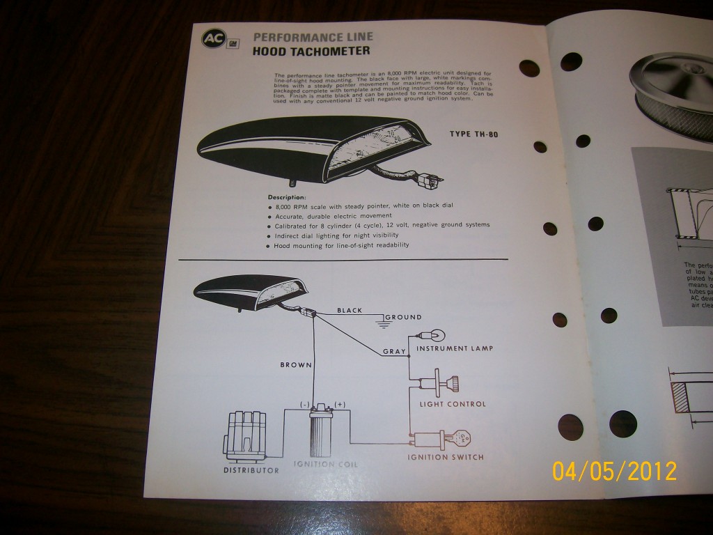

Thanked 56 Times in 36 Posts
Default Re: NOS AC Delco Air Filters A212CW AND A212CX
Here is the AC Performance line catalog circa 1971.
