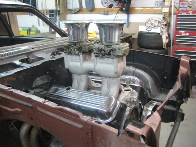

Marlin, Those bread box TR1's were absolutely horrendous on the street and it takes someone with experience to set one up right and even then it won't run as good as a TR with a smaller plenum. Even Edelbrock pitched it after one year of production and went to the TR-2X and discontinued the TR1. It was a poor design to begin with.
A friend of mine put one on his 70's style street rod he was building and it washed down his cylinder walls after a summer of driving and he and his friend who set it up have been setting up these systems since the mid 70's. He wanted a challenge..and it beat him.
I would suggest the Edelbrock TR-2X, or better yet the Weiand or an Offenhauser-both have a smaller plenum than the TR-2X and are very early 1970's correct. Offenhauser had a very good reputation for nice running street TR's back in the 70's because they had the best plenum shape.
Here is the engine in my 289 Mustang- Offenhauser with 2 Holley 390's-the pre emission carbs w/o all the smog junk on them.Disregard the date on the photo-it was not set the day I photographed it.
