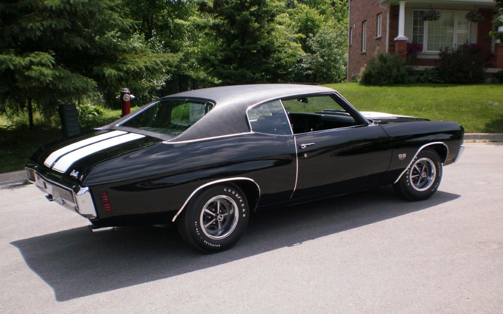

Default 1970 Chevelle SS 454 LS6 Rebuild + Details
This thread continues from were i left off on the previous thread topic on "Need tips on taking a 454 Motor Out"
https://www.yenko.net/ubbthreads/ubbt...552#Post467552
I will slowly show photos and details on rebuilding the Motor and it's surrounding parts.
I will also ask questions as i go along and ask to help identify parts.
All your opinions and tips will be much appreciated as you guys are a great help as always in guiding me in the right direction [img]<<GRAEMLIN_URL>>/biggthumpup.gif[/img]
