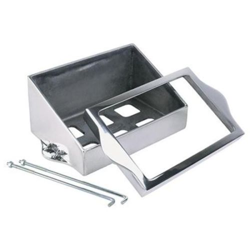

i found a few different versions. thoughts?

Middle one looks most era correct-maybe try to tone down the shine, get rid of the clear plastic hoses and uses black rubber instead.. Last one looks to billetly/modern with it's cast and polished brace. First one looks kinda amaturish but that is the look many are after with all out race cars.

thanks for thoughts. i think the first version was used in the mid 60s hemi cars. the second is aluminum. the third is polished but its availble without that shiny finish. i love this stuff
