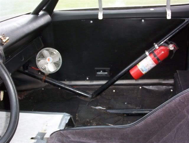

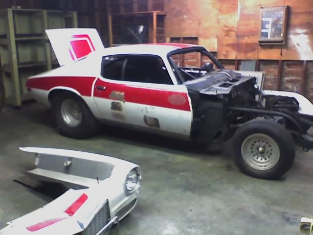

Here are some pics of the car as it sits now. in the pic of the back seat area with the passenger side wheel tub in t you can see the top of a post sticking thru the floor,thats the mounting bar for the 3rd link,a real Jenkins setup.
Now heres a real interesting pair of photos. Compare the pic of this roll cage and fiberglass dash to the black and white pic of the Jenkins backhalf 70 Camaro when Richie Zul owned it in about 1973. Cool huh?

3-link rear suspensions were the primary "thing" for ProStock cars in the 70s. If properly set up it would launch the car like a rocket. But the problem were just to set it up. The pictures of this one shows an early setup.
Later they started to make brackets for the upper rod to move the rod sideways. I have seen some cars that could move the rod 4" in sideway adjustments. Reason for this was that if the rod were not in the perfect side adjustment the car would launch in a twist, in extreme cases resulting in lifting the left rear tire. This made it really difficult to dial in the suspension on different track conditions and eventually they moved to 4-link setups that were more controllable even though they were not as good as a 3-link.

Yup Mark,that definatly looks like it was built in the early 70's as a pro stocker or late 70's as a modified production car. I doubt it was an SRD car that was built for pro stock. In 70,a few of the cars were running the old bolt in bars,and by 71 most SRD cars had the type of cage thats in the pictures I posted. Notice how the door bar actually goes from the main hoop directly down to the floor mid way along the door opening right over where the subframe mounting ara is,then another bar extends foward from there and goes to the firewall where it is bolted to the firewall with a plate on the outside of the firewall that has a bar that is welded to the front subframe.The top driver's side door bar was aded later on. The bar that runs down the front windshield(a-pillar) doesnt go all the way to the floor,it mounts to the top of the bar that runs to the firewall. The drivers side bar on the car in the pics was added later. as far as I know,this cage wouldnt have been legal to run faster then 10.0 anytime after about 1980. Prety much all prostockers buit after 1974 were tube chassis cars.
As for the Jenkins 3 link,if you look at this car,you will see that the mounting bar is centered in the car. I believe his setup used a link that was actually more like a wishbone that acted to both center the axle and provide suspention.This car had aftermarket frame rails in the back,and the entire floor was cut out and a box was built to cover the 3 link setup,and that box was at least as big as what would be needed to clear a 4 link.

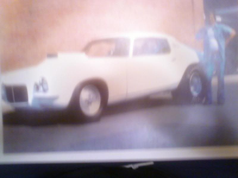

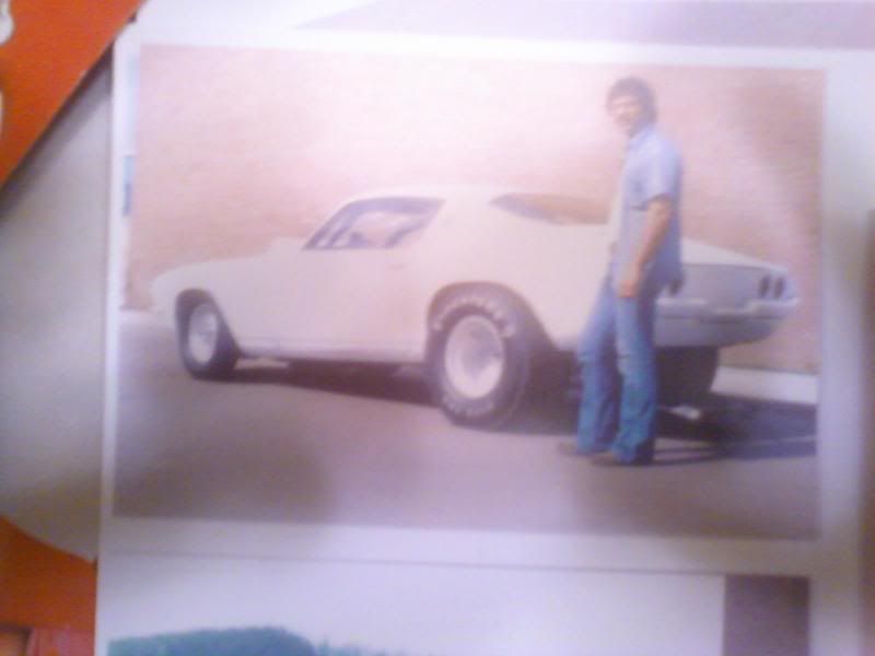

Here are some pics of the car from back in the day. After it was sold from SRD,the car was raced as a gas class car. I spoke to Pete Huntchinson from SRD about the car,and he said they never built a 2nd gen backhalf car for pro stock,but the front end work looks like a car they built for Wayne Jesel. I contacted Wayne about it,and am also waiting a call back from Derrick Von Bargen,who was the D in SRD,and part of the Jenkins "super crew" back in the day. Here are the pics. They aren't great,but you can get the idea.
